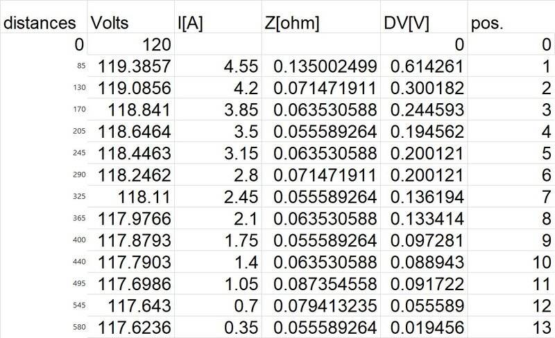

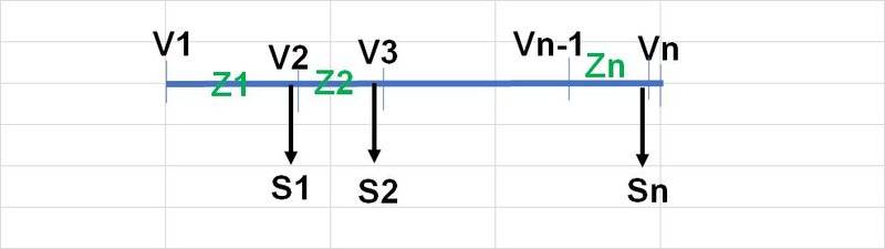

I'd say this is what separates the electrical engineers from the electricians. If you have a long pair of wires with taps along the length of it, each tap drawing currents, you have to solve this by drawing out a circuit including the resistance of the wire. You will end up with a network of resistors that is solvable using basic circuit analysis.
DV1=Z1*SUM(I1,I2...In)
I1=S1/V2 and so on.
DV2=Z2*(I2,I3...In)
Usually we know Vn and then we may build the voltage line as Vn-1=Vn+DVn
DVn=Zn*In
In=Sn/Vn
If we only know V1, we must first consider all V2 to Vn equal to V1 and iterate the voltage drops as many times as we need to achieve the proposed error limit.
The result may be like this:
All currents are assumed to be equal to 0.35 A and the voltage variation at each point does not produce current change.
If the circuit consists of two conductors of the same type - forward and reverse - we will have to multiply by 2 -in the table I did not!.
Let's consider the power injected in each point is constant P(i)=I(i)*V(i)=K P=120*0.35=42 W
In this case first we take V1=V2=...Vn=120 V
I(i)=42/V(i) and finally -after 2 iterations-V13=115.0779V [the error is 0.000313%]

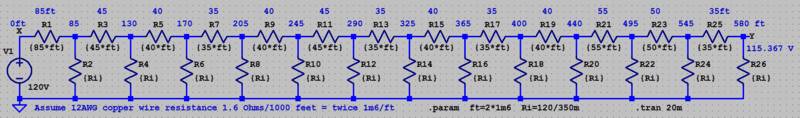

If the supply voltage was 120 VDC; and assuming 12 AWG copper, for both the supply line, and the return line; and the loads sink a constant current of 350 mA DC;
Then 115.212 volts DC would appear across the terminals of the final current sink.
Do the loads sink 350 mA RMS, or a constant current of 350 mA, alternating with supply polarity ?
Or maybe have a resistance of; 120 V / 0.342 A = 342.857 ohm.
There can be many answers to a poorly defined problem.

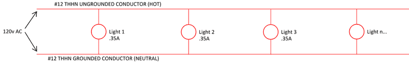

This is actually a real world install. The .35A loads are LED bollard lights installed along a walkway. The #12 is THHN insulated wire installed 24" underground in PVC conduit. (I believe we actually installed #10 THHN) The 120v is AC nominal voltage,(could be anywhere from 115-125v, let's figure 120v). It's one circuit connecting all the loads. Being 120v, it would be two conductors. One grounded and one ungrounded conductor. (Hot and Neutral) In my table the "distance" is the approximate distance each light is from the source (the breaker panel).
So if given this information, what would be a formula(s) for calculating what we should expect to see for voltage at any point along the circuit knowing the distances and loads before and after?
(I'm tempted to just go there and turn them on and test at different points, but I want to understand the science of this:biggrin: out of pure interest in understanding.)

Input 120 VDC. End of the line; 115.367 VDC

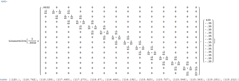

Using Baluncore's 1m6 ohms per foot for 12 ga, and a constant current draw for each load, the resulting voltage at each load point can be calculated, with an end-of-the line value of 115.212 volts. This is hardly different from the result with a constant resistance for each load.
I suspect the result with a constant power (for constant brightness) load would also be hardly different.
For a constant, polarity dependent, current draw from a supply of, 120 VDC or 120 VACrms, without reservoir capacitor:

As above but with resistive loads:

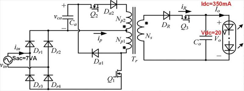

  • #32
It seems that actually it is a little more complicate.
The supply voltage is AC -as usual- and a driver AC/DC is provided in order to supply DC. Then 350 mA it could be the DC output [18-42 V].Let’s say Vdc=20 V Pdc=0.35*20=7 W.
In the interval of 115 to 125 Vac the LED current is 350 mA, but the Iac current is variable from 7/115=0.06087 to 7/125=0.056 A neglecting the losses and power factor.
If we consider 0.8 as power factor and 95% as efficiency we get
S=7/0.8/0.95=9.21VA and the currents Iacmin=9.21/125=0.07368 A and 36.87 degrees
Iacmax=9.21/115=0.08 A and 36.87 degrees.
