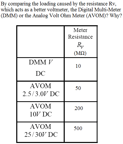

I think that the AVOM meter would act as a better voltmeter. This is because it has a higher meter resistance, meaning that it is more sensitive. Therefore, it will disturb the circuit as little as possible and it will draw less current to operate compared to the DMM.
Is my answer correct?

Higher resistance is good, as when the meter is placed in parallel with the circuit, the very high parallel resistance will draw very low current, and thus not change the circuit operation in noticeable ways. Do some math with a simple circuit with a 1V source and a 1R resistance representing the circuit, and then put a 500MR resistance representing the meter in parallel and see how the current is split.

Do you mean that an AVOM gives more accurate readings than a DMM? Do you have an explanation or justification for this?

What power sources do AVOM and DMM use, and why does one draw less current to operate than the other?

I meant that an AVOM has a higher "ohm per volt" value.

By "disturb" I meant that the AVOM meter will draw less current from the circuit.
The DMM and AVOM used a DC power supply (this question is from a lab experiment). I think that the AVOM meter draws less current than the DMM because it has a higher resistance. More specifically, a voltmeter with a high resistance will not alter the resistance ratio of the voltage divider circuit as much.

Yes it is generally correct.
I like this one better than the original!
Good quality moving coil multimeters have 50 µA movements and a sensitivity of 20000 ohms per volt.
So, for example, they have a resistance of 200 000 ohms on the 10 volt scale. That is 200 K.
To check this, if it was connected to 10 volts DC on this scale, the current in the moving coil would be 10 Volts / 200000 ohms or 50 µA.
Notice that your table indicates a resistance of 200 MEGOHMS for this scale. This is not correct.
If the multimeter had a range of 25 volts full scale, the resistance of the meter on this scale would be 500 K. Your table indicates 500 MEGOHMS, which is incorrect
Good quality digital multimeters have a resistance of 10 MEGOHMs which agrees with your table. Cheap ones have a resistance of only 1 MEGOHM.
