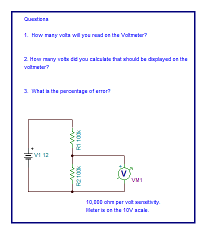

a 12v dc supply is connected across 2 100k resistors in series.a voltmeter having sensitivity of 10,000 ohms per volt is switched to its 10v range and is connected to its 10v range and is connected to measure the voltage of 1 resistor.
1)sketch circuit
2)calculate voltage reading
3)calculate percentage error of the meter reading in 2
I can draw the circuit that part is fine.im using v=ir to try and workout voltage so 100,000/10000 = 10
and for the percentage error 100/10 =10%

Sorry, I'm not understanding where the values are coming from, and I'm not certain what the r, v, and I are meant to mean.
Can you draw a circuit diagram and label the parts with their values?

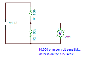

attach
Okay, what resistance value are you going to assign to the meter (Let's call it Rm)? Remember, it's rated at 10,000 Ohms per volt and it's on the 10 Volt scale...
ok rm I would say 10,000 x 12dc v = 120,000/10v =12,000r

Well, no, it's asking for the voltage reading on the meter. The meter is connected across R2 (according to your figure):

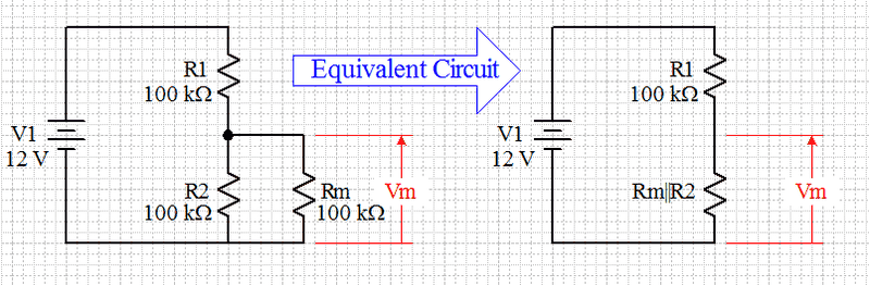

Can you explain in words what you're trying to accomplish with that calculation? I don't see resistor R1 being in parallel with anything, so "(resistor 1 in parallel )" confuses me. When I look at the circuit I see resistor R1 in series with the parallel combination of R2 and Rm. Look at the equivalent circuit that I posted above (post #22).
From now on, don't just show me numbers. Show me symbols first. Use R1, R2, Rm and V1. Add variables as required, but define them. So you might say that for the parallel combination of R2 with the meter's resistance Rm that Rp = R1||Rm, which is Rp = 1/( 1/R1 + 1/Rm) = 50k Ohms. Then you'd have the variable Rp to use for that value.

Write:
Parallel resistance of R2 with the meter resistance Rm:
##Rp = R1 || Rm##
##Rp = 1/ (1/100k + 1/100k) = 50k## Ohms
Total circuit resistance with meter in place:
##Rt = R1 + Rp##
##Rt = 100k + 50k = 150k## Ohms
That should help make things clear.
Now, can you show a calculation for the voltage across the part of the circuit where the meter is connected?
