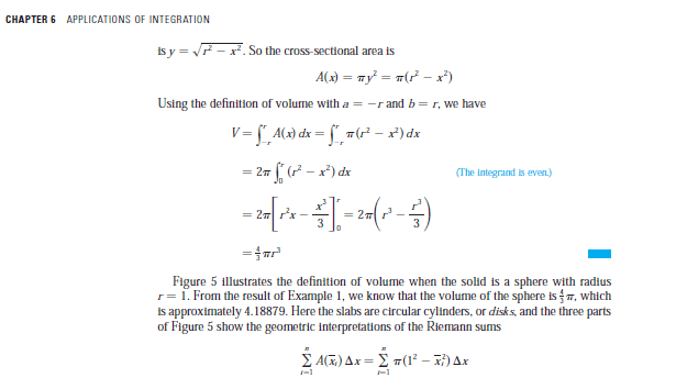

Show that the volume of a sphere of radius r is
V = (4/3)πr^2
calculus, integration
I have the solution in the book but it's confusing me, I'll attach a picture.
So I get lost where it starts talking about a cross-sectional area all of a sudden multiplying by ∏. What's going on here?!
What's the area of a circle of radius r? What if the radius is y instead of r?
V = (4/3)πr^2
Probably a typo - the volume is (4/3)##\pi r^3##.
The book is using disks that are oriented vertically (the x-axis intersects each disk perpendicularly). The volume of such a disk is its area times its thickness, dx.
