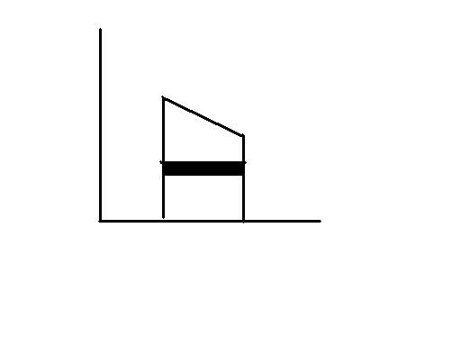

Problem:
Find the volume of the solid:
y = 2 - x/2 bounded by y = 0, x = 1, x = 2.
Answer: 19pi/12... I already know how to get the answer but...
what if wanted to use horizontal rec? For instance If I am using the vertical rec... the radius would be y = 2 - x/2... but if I use the horizontal rec would the radius be x = 2(2 - y) ? I tryed this value and integrated from y = 0 to y = 3/2... but did not get the correct answer...
Is it not possible to get the correct answer using horiz. rec?

Miike012 said:
Problem:
Are you rotating this trapezoid around the x-axis to form the solid of revolution?
If so, then integrating w.r.t x is the disk method.
Integrating w.r.t. y is the shell method (cylindrical shells), so the radius is y itself. You will have to break the integration up into sum of two integrals.
Yes I am rotating across the x-axis. So is it possible to use horizontal rec?
Where can I learn about the shell and disk method? My teacher didnt mention these techniques.
