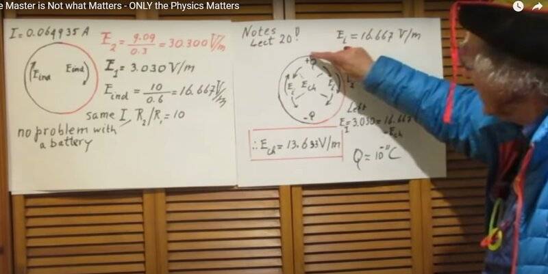

  • #48
I have to mention again that this treatment of describing the electric fields generated by the charges on the surface of conductors in an electromagnetic induction system, and further analyzing the interaction of the electric fields generated by these charges with the induced electric fields, is certainly not my own idea or invention. I found a lot of this material on the Internet, Dr. Lewin's lectures on his circuit paradoxes were also one of my study objects.
Note that Ei is the induced electric field and Ech is the electric field generated by the surface charge, Q+ Q- are positive and negative charges respectively
  • #49
What's the timestamp on this video? I want to understand your thinking here.

  • #51
For those interested, you can refer to the video link I added in #12 of this discussion thread. I personally think that watching it from 33 minutes will be the most exciting part, but this may not let you understand the whole interesting story.
Frankly, I don't really understand some of the debates raised here, such as what is mainstream and what isn't, leading students away from the most important subjects of study, etc. I am an engineering graduate and have been engaged in engineering for decades. I don't know anything about the academic world of physics, but I am very interested in physics. What I care about is whether the method used is reasonable, whether it will find the right answer, and most importantly, whether it will violate the laws of physics. If there is a simple and sound concept and method that can show correct results, why are some people so negative about discussing and using it?
This is just one of the options available, I don't think anyone is trying to lead others not to learn from the mainstream and the best.

@tedward it seems to me you still believe that the pie shaped leads @mabilde uses to sweep around the single turn loop contribute to the voltmeter reading on their own. This is not so. Once you can understand this I think you will understand the broader picture of what is going on in many places of this so called paradox.
You say the pie shaped wires in the @mabilde video form a loop and imply that this alone is what causes the reading. If we were to extend the wires in this loop out radially alot farther before we form the loop, what do you suppose would happen? In other words, we have a large pie shaped loop but it is not part of the round loop that was previously swept around. If the round part of the new loop is significantly far away the solenoid the pie shaped loop will generate a very insignificant voltage. The flux from the solenoid is not strong enough to CUT the now larger part of the pie loop. It's too far away. Remember the violin strings/bow scenario I described? The radial wires inside OR outside the solenoid will contribute nothing.
  • #59
tedward said:
I'm not 100% sure I get you, but it seems that you're saying the scalar potential increase really describes the energy added by the induced field. I'm not sure I agree with that. If you look at the combined field, the only place energy is added (non-zero e-field) is in the resistors.
Yes, because a resistor is connected in series, then the potential energy does not increase, and the energy supplied by the induced electric field is immediately lost on the resistor, but if the resistor is replaced by a capacitor, the charge stored in the capacitor will increase, and the corresponding potential energy also increased.
  • #60
This is correct. In really really dumbed down layman's terms, the battery/transformer secondary/etc. does something and the resistor immediately undoes it. All of this ties together. The internal resistance of the lowly AA battery is what 'undoes' when the AA is shorted. The resistor wire loop that has been discussed in the single turn coil measures zero because the 'doing' and 'undoing' are happening in the exact same space. When the voltage source is separated away from the load, the voltages and currents we are all familiar with make more sense. Only because it's familiar.
  • #61
Ok, this tells me that you have a fundamental misconception about how induced emf works. You need to learn it the right way if we're going avoid talking past eachother. Take your example from earlier of putting voltmeter leads around a solenoid, we can learn a lot from this. Starting with just the voltmeter by itself (no solenoid), shorting the leads gives you a reading of zero, as they should. No flux, no emf. Now take the leads and put them around this very tall (say infinitely tall) solenoid and short them on the other side. Now there is a changing magnetic flux in your measurement loop. Think of the imaginary surface formed by your loop, like the soapy film on a plastic wand for blowing bubbles. The flux lines penetrate through this surface perpendicularly. The emf is determined by the rate of change of the total amount of flux penetrating this surface. That's Faraday's law.
The voltmeter will now read this emf. If you move the wires around, as long as the total flux in your loop stays the same, the emf reading will not change. Say you make your voltmeter loop much bigger, but the same solenoid is still inside. The total emf WILL NOT CHANGE, because the amount of flux through your loop has not changed. (Now, in the real world, the solenoid is not infinitely tall, and the field lines will circle back back around again, passing through your loop, canceling out the flux. But that's just a problem with this particular setup, there are ways of avoiding a return path and you can make your loop as big as you want, like confining the magnetic field to a torus shaped iron core).
Here's a another thought experiment. Take your voltmeter leads, and short them so it reads zero. Hold your loop right next to the solenoid, but just make sure the solenoid remains outside your loop. The voltmeter will still read zero. This is because there is no flux through your loop. No flux, no emf. We see that flux can only cause an EMF in a LOOP. It doesn't cause an emf in a section of a wire. Now you can talk about induced ELECTRIC FIELD in a wire, certainly.
The only way an emf can manifest itself is with an electric field, which is why considering the field is crucial. Say this particular loop (with the solenoid near, but outside), is long and thin, so two long wires connected by very short segments, with the solenoid outside next to a long wire. The solenoid will try to exert an induced field on both the long wires, but in the loop these are opposite directions, so they cancel eachother out, and there is no net electric field in any of the wires - i.e. no emf. The voltage drop across any section is therefore zero. (I think it's slightly more complicated than that as I believe some static charge will reposition themselves, but the end result is still the same).
So in your idea of extending the pie shaped loop - in the ideal sense, with the solenoid infinitely tall (so no return path), it would make no difference. The reading would't change. In this real setup, once the loop gets big enough you will catch the returning flux and it will cancel out to zero. But this has nothing to do with distance, just a limitation of the practical setup. If the solenoid was wrapped around an iron core in a rectangular donut type shape, with the other end of the rectangle outside the loop, we won't have this problem and you can make your loop as large as you like.
Now here's another experiment to convince you of @mabilde's error. Say he's measuring a section of conducting wire in his set up. The real voltage is zero, but he's reading an emf. This is due SOLELY to the flux from the solenoid, not the scalar potential (which is non-physical on its own). Now, change the area of the loop. keep the contacts on the wire ring where they were, but press the lead wires together, so the loop becomes a closed T-shape with no area. Now there is no flux from the solenoid through this loop, and you will read zero volts, as you should. This is why his setup is so carefully made - to get precise measurements from the emf that exactly line up with the derived value for scalar potential. It occurred to me thinking it about it this morning that he's doing this intentionally to pretend he's measuring the scalar potential. It's a bullshit measurement. More on this - I have a rant coming....
[And by the way, your mental model of the" violin bows" of the flux cutting across the wire is simply wrong. I used to imagine something similar until I realized that the magnetic flux can be set up to exist only in the center, nowhere near the circuit wires, and you still get an emf. Read up on Faraday's law!!]

I think the test method used by mabilde is correct. When we measure voltage with a voltmeter, the DUT has to supply energy, so the Lewin circuit has to supply energy, so the voltmeter loop has to somehow let the changing magnetic flux through to get the energy, otherwise it won't be able to measure anything thing.
Of course, according to Faraday's law, the test result is the induced EMF in the pie-shaped area due to the change of the passing magnetic flux. But this is not enough to prove that it cannot represent the scalar potential difference generated between the ring arcs at the same time.
I think whether you agree or disagree, both parties should try to come up with some stronger arguments to support it. The method you said of pressing the leads together so that the loop becomes a closed T-shape with no area is problematic because the leads of the voltmeter will be affected by the induced electric field. When you are trying to measure the potential difference created by a pure charge, do not subject the voltmeter and its leads to the induced electric field, this may cause errors in the measurement results.
I reiterate my opinion again, I agree with mabilde's method is correct.
