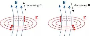

  • #91
AC vs DC is not really the issue. Batteries are DC, but you could also have a non-induced AC source that is in the loop, at least ideally. We used to model use these models in circuit analysis class all the time. Similarly, our transformer does not have to be AC. If you manipulate the external magnetic field so that it is increasing linearly, you essentially have a constant, non-oscillating DC emf, which is often a simpler model for these kinds of problems. With math,
B = kt (linearly increasing magnetic field)
dB/dt = k (constant derivatie)
emf = -k*area (constant flux rate in a single direction everywhere)
So this induced DC emf can certainly add up to non-zero around the loop. It's always in, say, the clockwise direction. As for AC, I think you mean that the field polarity adds up to zero OVER TIME. But freeze time at any moment where the field peaks, and it's all in one direction, just like the DC case. Every point in the loop at a single moment has a clockwise emf, half a period later it's counter-clockwise.
Transformers do have a small resistance, as there is a lot of copper, but it is usually negligible compared to the load resistance. I promise you - when we talk about the voltage output of a transformer, we are not talking about the negligible ohmic voltage drop across the transformer windings. This is a classic source of confusion. Certainly in the ideal case, the ohmic voltage drop across the windings is neglected completely without affecting anything.
At some point in every E/M physics class, a bright student will ask the question, how can a transformer (or inductor) have a voltage drop across it if it's resistance is effectively zero? You will usually get a hand-wavey response unless the professor knows what they are talking about. The answer is certainly NOT the ohmic drop through the windings, which is zero. The real answer is at the HEART of this entire problem. The answer is path dependence due to the non-conservative electric field. Measure the path outside the terminals, you get the emf voltage. Measure a path through the windings (as I've described several times) and you get zero. Two different paths, two different values. That's becasuse the loop that connects them has a changing flux, the Faraday term on the right side of his law, -d(phi)/dt. The sum around this loop is not zero, it is equal to the emf. Hence the path difference. This path dependence is usually hidden in a coiled up transformer, but is exposed when you unwrap the transformer into a single loop, which is the ENTIRE POINT of Lewin's demonstration.

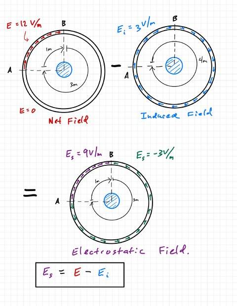

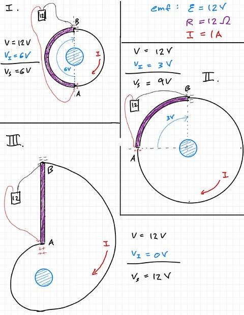

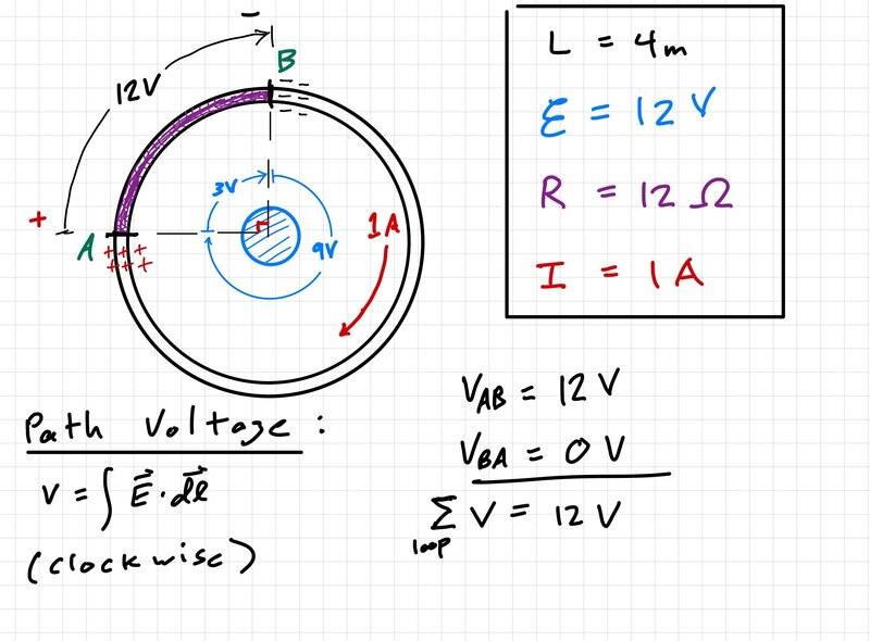

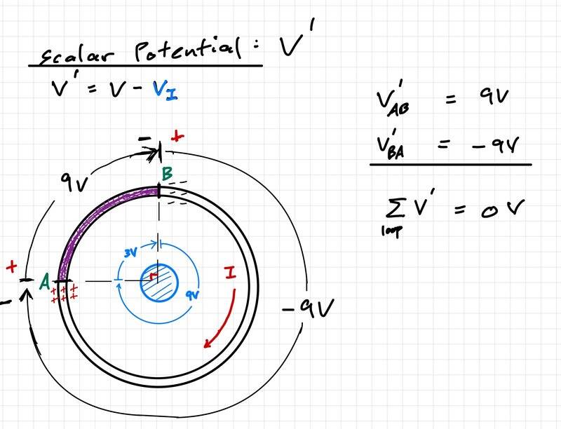

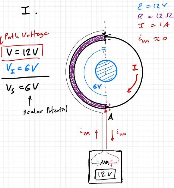

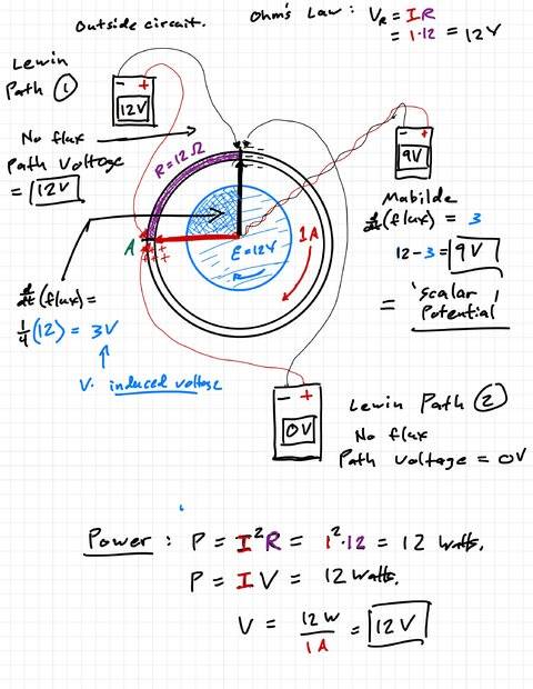

THE TEST LEAD QUESTION
An important question that keeps coming up is whether or not a voltmeter measurement in a circuit with an induced emf, placed either across a resistor or a section of conducting wire, 'masks' the intended measurement because it is subject to the same induced field as the section being measured. It's a valid concern, provided there is actually something there to measure. The answer to this question depends only on your choice of voltage convention.
Certainly we don't have this problem when we measure a resistor in a regular DC circuit. A voltmeter is a just a resistor placed in parallel, so it's true voltage (and reading) is exactly the same as the measured resistor. But isn't it subject to the battery's emf as well? Of course it is. You can look at it either way - "measuring" the resistor's voltage, or reacting to the emf in exactly the same way as the resistor. It's the same thing said two different ways. Does it make a difference if we're talking about induced emf?
Let's say we're trying to measure the 'scalar potential' in a section of conducting wire in an induced-emf circuit, just wire around a solenoid with one lumped resistor. The scalar potential here is the integral of the Electrostatic field only:
##V_s = \int{\vec E_s \cdot\vec dl} ##
In this case ## E_s## can be thought of as the negative of the induced field that would be present if it wasn't canceled out, or as it would appear in free space. Some people refer to this as the 'emf' in this section of the wire (a term I object to, but I digress).
I place my voltmeter in parallel with the wire section. The wire has a presumably non-zero scalar potential between the two points of measurement, and for the exact same reason my voltmeter leads have the same scalar potential as long as it closely follows the DUT. The voltmeter should read zero as the 'potentials' in the wires cancel each other out. It certainly does, so it seems like this argument works in this case. We now know that voltmeters can't measure scalar potential independently. (Keep in mind the scalar potential is just a mathematically derived quantity anyway, charges have no way of responding to it independently of induced field).
Now say we want to measure the 'path voltage' between two points on a wire. This the standard (in my opinion) definition of voltage that is measurable, and corresponds to the integral of the total E-field along a path:
##V = \int{\vec E \cdot\vec dl} ##
This definition is the same as the voltage drop across a resistor from Ohm's law, and actually represents the work done on a test charge between two points along a given path. So let's hypothesize that there is an actual non-zero path voltage that doesn't disappear in steady-state. Well the same non-zero path voltage would occur in the lead wires, as the argument goes, so the zero reading (same one we got before) doesn't tell us anything.
Since the measurement itself is suspect, we have to simply find another way to determine what the path voltage should be, in order to determine if voltmeter measurements are valid. Luckily, as path voltage corresponds to net electric field, this is easy to do. Net electric field, the only field present that actually exerts a force on a charge, is the sum of induced field and electro-static field:
##E = E_i + E_s##
In the steady-state case (after charges have reached equilibrium, virtually instantly), there can be no net force on a free charge in a region with no (or negligible) resistance, or you would have arbitrarily large / infinite current. Since the net force on any free charge is zero, then the net electric field must be zero, since electric field determines the force felt by a charge according to:
##\vec F = q\vec E ##
So we can rest assured that the net electric field in a section of conducting wire between resistors is zero. Since the definition of path voltage is the integral of electric field, this means that the voltage drop - the same voltage drop we use with Ohm's law, is zero, in perfect agreement with our voltmeter. This also means a voltmeter measurement across a resistor only measures the resistor's drop, and we don't need to worry about 'missing' the voltage in the wire, because there is none.
This makes perfect sense. If the (completely valid) argument is that voltmeters are not immune to physical effects of the circuit, then they must be affected by both induced electric field and static field, just like the section they are measuring. If these effects cancel out in a conducting wire - and they do - than they cancel out in the leads on a voltmeter, resolving the issue.
When does your voltmeter give incorrect readings? Whenever you have changing magnetic flux passing through your measurement loop, due to the induced emf, per Faraday's law.
CONCLUSION: You can't use a voltmeter to measure the mathematical concept of scalar potential (regardless of whether it cancels out in your measurement loop, or is simply non-physical). A voltmeter ONLY measures path voltage. If you're using the standard path voltage convention, (and there's no flux in your loop), you can trust your voltmeter.

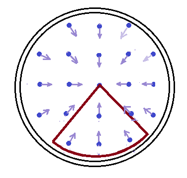

I still keep coming back to the same thing. The measurements @mabilde makes from the center are correct. I've explained how I think this is possible. I used the rubbing of violin strings vs cutting through as an analogy. You didn't buy it.
You've implied that magnetic fields do not act on a wire, they act on a loop. Well, that's a bit of a BS thing to say considering we cannot measure it unless we form a loop. So it's pointless to introduce such ridiculous statements. Flux cutting through any tiny small portion of the wire will cause induction.
Unless I have misunderstood, you have also implied that a loop outside of the solenoid is immune to the changing flux. This is false. It can be proven by sorting voltmeter leads together and orienting them around on the outside.
Now for some specifics. You claim that the pie shaped affair inside the solenoid is just a pickup loop. That is an understandable position, but wrong. My position is that the pie shaped wires are not cut by the flux due the orientation with the field. I back this up by pointing out if it were just forming a pickup loop it would not read zero in the case of a shorted loop. Your position on that argument is that it is just canceling. That argument is not valid since the current in the pie shaped loop will be in the same direction as the large loop. There was talk about the pie shaped loop being a simulation of the real loop. This is an understandable thing to buy into until we disconnect the pie from the main loop and and give it its own stand alone arc at which time it will read the same as when the pie was directly connected to the main loop when the main loop was not shorted.
We need to come to an agreement about how the conductors behave in the B field while moving in various ways relative to said field. I have my doubts if we will.
I'm also not certain you have agreed that a shorted secondary ring in this setup can not have any voltage measured anywhere on it when the probes are placed correctly.
All that being said, I think your last post is simply a more confusing way of saying all of the things you've already said previously in this thread.
If anywhere in this post I have misunderstood your position on something I am sorry and invite you to clarify. Although I doubt I have misunderstood anything.

alan123hk said:
The test method used by @mabilde is undoubtedly correct...
My personal idea is that there is no such thing of "simulate measurement", unless you manipulated it intentionally and improperly, or it was just simulated on the computer.
I get your point about 'simulating' a measurement. If I want to measure loss of energy due to friction of an object moving on a surface, I can measure the kinetic energy at two points and subtract them - even if I can't measure the heat dissipated in the air directly - and report it as friction loss. So part of my issue might be philosophical, but a lot of it is certainly about intent. Again choice of convention plays a big role here.
Mabilde is an EE professor (iirc), and likely subscribes to the convention (which is as far as I can tell unique to that field) that 'voltage' refers to 'scalar potential' only - though he never states this. He references Kirk McDonald's paper in his analysis, which defines scalar potential strictly as the electrostatic potential between points of accumulated charge at the ends of the resistors. Defined this way, this potential certainly adds up to zero around the loop, as the electrostatic field, on it's own, is conservative. This is apparently what he's trying to measure around the circuit.
As I laid out in my last post, the scalar potential between two points, at least in a section of conducting wire, corresponds to the induced voltage that would be felt between two points in free space. But we're not in free space anymore, this is conducting wire with a lumped resistance in the active circuit, so the net E-field here is in fact zero. The induced voltage / scalar potential in this region now ONLY exists as math, because charge cannot respond to it independently (all the electric field is concentrated in the resistors). But fine, let's pretend it's there. We're essentially asking what would the induced voltage be in this the section of the wire, either in free space or before the fields had reached an equilibrium.
You can't measure this quantity with a direct voltmeter measurement, simply based on the argument that has been raised repeatedly: that voltmeter leads cancel the thing you're trying to measure, since scalar potential, as it's defined, can exist in conducting wire. But one way to do it is to set up your voltmeter leads so that it feels the exact same amount of flux - and therefore emf - that correspond radially to this very symmetric circuit. This subtracts the portion of the emf through the loop from his measurement, giving him a non-zero number that of course changes with the angle of his pie-slice: both area of he slice and the arc-length are proportional to area.
Now if he's trying to measure this abstract quantity, and he describes his intent, his process, and how he intends to measure it, I have no problem. But consider what he states he's measuring. I'll have to watch the video again, but as I recall he never mentions the words scalar potential (tell me if I'm wrong), only 'voltage'. He certainly never discusses different voltage conventions (scalar potential vs. path voltage). So he's assuming everyone watching subscribes to the same definition that he's been trained, as apparently EE's are, to use. So, by using his set up, he sure makes it look like he's measuring something real in this copper ring - that charges actually gain/lose energy as they move across this conducting wire, even though absolutely no work is done on them as there is precisely zero net field there. He then proceeds to show, that the energy gained in the conducting wire is lost in the resistors. This is only true from the scalar potential convention, not from the common understanding of voltage (the true net work done on a charge per coulomb), as the net work done on a charge around the loop by the electric field is most definitely not zero.
Now consider his audience, which includes anyone who watches youtube who's interested in physics: certainly high schoolers, college students, teachers and other academics, and the casual science buff. They're convinced, as they saw with their own eyes, that there is a measurable difference in voltage / energy between two points of zero resistance conducintg wire. So of course, when they do a voltage sum, thinking they're using the more common path voltage convention, they have to take this into account, and the loop sum must be zero!! But most of the audience is not familiar with the technical differences in convention, and most assume we're talking about the standard type of voltage - the type that Lewin is using. So Lewin must be wrong!!
In reality, the emf provided by the flux term is ALREADY TAKEN INTO ACCOUNT in the resistors, and factoring in the scalar potential in the copper ring just subtracts this sum to get zero. So without understanding this strict convention, the audience has been forced to accept scalar potential as a convention unwittingly. What do they learn? That an induced emf circuit works exactly like a DC battery circuit, and the sum of the 'voltages' around the loop is zero. Therefore Lewin is simply confused, and path independence (a fundamental physical idea) is nonsense.
  • #107
tedward said:
I'm also very curious what you think of the test lead question post.
The thick blue line outside is a section of the ring circuit, and the thick red line is the lead wire of the voltmeter pressed into a T shape. Both are conductors, so charges accumulate on their surfaces to cancel the induced electric field. Since the induced electric fields inside them are almost equal, the potentials generated by the accumulated charges on their surfaces are also almost exactly equal.
Obviously, the potential difference generated by the charge measured by the voltmeter now moves from the two points a-b to the two points c-d, which should be roughly equal to the arc length between points c and d multiplied by the induced electric field.
Also, of course I admit that Farady's law is the basis of everything and is the king, because it is always correct.
The distance between the associated thick red and blue lines is approximately zero. I've separated them slightly for easier viewing.

First let's get our picture right. In our solenoid, current through the windings generates a magnetic field. The field points vertically (oscillating up and down) along the axis, is uniform, and only exists inside the solenoid volume. I'm using the common assumption of an infinitely tall solenoid to avoid worrying about the return path flux, which is a practical consideration but not relevant to the ideal case. The point is that there is no flux between the solenoid and the loop circuit, even if there is considerable distance from the solenoid to the loop wire.
MAGNETIC FLUX
What is magnetic flux? It's the amount of magnetic field, summed over a defined area, that passes through that area. The calculus version is written like this: $$\Phi_B = \iint \vec B \cdot d\vec A $$
In a simple situation like ours, it reduces to a simple formula: $$\Phi_B = BA_s$$ where ##B## is the magnitude of the field in the solenoid, and ##A_s## is the cross section area of the solenoid only, regardless of the size of our circuit. We only include the solenoid area as there is no magnetic outside the solenoid to contribute to the sum.
FARADAY'S LAW
How does it affect the circuit? Faraday's law (applied to our situation) basically says two things. First, if the flux through the solenoid changes in time, it creates an electric field in space that surrounds it, always encircling the solenoid in one direction. It also says that that the circulation of this electric field, meaning the total sum of the field on any circular path around the solenoid, equals the time rate-of-change of this magnetic flux: $$\oint \vec E \cdot d\vec L = -\frac {d \Phi_B}{dt} $$ In space, you can picture the electric field as clockwise arrows circling the solenoid, where the field strength decreases with radius but the total sum of any circular (or any path) is always the same. This is an important point - the electric field strength decreases with distance, but the total circulation is the same no matter the radius. And that circulation is always non-zero, as long as there is a changing flux. That's what non-conservative means. The negative sign is just there as a nod to Lenz' law, which says the direction of the induced field opposes changes in the flux.
EMF
When our circuit loop is placed around the solenoid, this electric field interacts with free charge in the loop, pushing charge around and creating a current. Inside the circuit, we now refer to the circulation of the field an electromotive force, or emf. $$emf = \oint \vec E \cdot d\vec L $$ This emf is a property of the entire loop itself, and is also called the induced voltage of the circuit. It's important to remember that emf is not some new mysterious physical quantity. It's just the sum of the induced electric field over the length of the loop. The ONLY manifestation of induction here is via electric field.
As consequence of Faraday's law, we can also say that any closed path that has NO flux penetrating it, has zero emf. This is really handy when analyzing voltmeter loops to make sure that they are unaffected by unwanted magnetic flux. In fact, you can apply Faraday's law to the entire circuit loop, smaller loops in a network, loops that other have other loops inside them, paths through free space, or any combination of circuit and free path. It always works.
Now let's talk about your model for a second. You have spoken several times of your 'violin string bowing' picture. The best I can tell is you got this from an induction generator picture (like the video you linked to), which involves a fixed field and moving conductor. In this case, there is no electric field directly responsible for moving charge - it is simply the magnetic force (one part of the Lorentz force): $$F_B = q \vec v \times \vec B$$ Interestingly, this different physical phenomenon gives rise to exact same equation - Faraday's law. The Feynman lecture I linked to (did you bother reading it?) discusses this ambiguity.
So how do I know your model is wrong? Because the magnetic flux, as we said, only exists in the solenoid. It does not have to come in contact with the loop. The loop could theoretically be at any distance, with no magnetic field of consequence in between. So this bowing picture with flux interacting with the loop, on it's face, falls flat. Now I don't want to confuse the issue, but the purist in me needs to mention that the way the induced electric field is created in the first place is via an electromagnetic wave, assuming the flux is oscillating like an AC source. The 'M' in this EM wave plays no part in our analysis, as it does not contribute to flux or do work on any charge in our circuit. And if the flux in the solenoid is increasing linearly, as many examples treat it, there is no magnetic field at the loop at all.
Obviously, in Mabilde's setup, he does put his copper ring as close as possible to the solenoid. This is to avoid the practical issue of the returning path of the solenoid field (comes out the 'pipe' at the top and turns around to re-enter at the bottom) which has much weaker field strength but could certainly affect measurement loops.
So now you should be caught up. That's what we mean by flux. We do not speak of flux 'cutting through wires', that is meaningless. Certainly induced electric fields have a physical effect on wire sections, either alone or part of a circuit, but I'll address that in another post as well as some of your other points.
