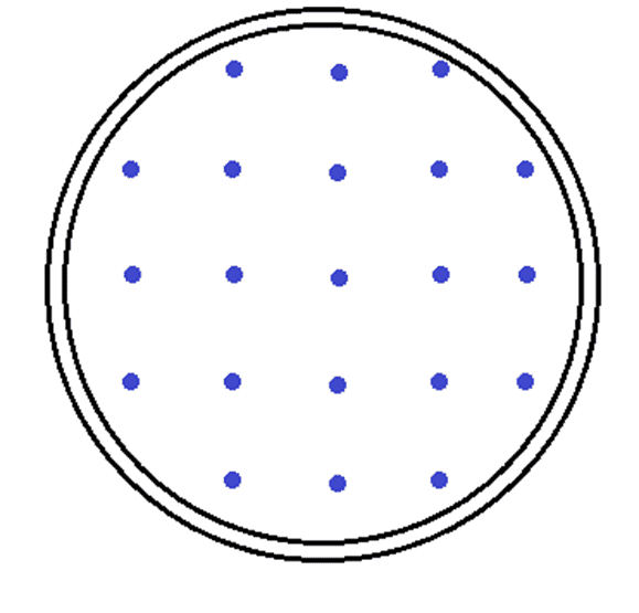

Averagesupernova said:
@tedward it seems to me you still believe that the pie shaped leads @mabilde uses to sweep around the single turn loop contribute to the voltmeter reading on their own. This is not so. Once you can understand this I think you will understand the broader picture of what is going on in many places of this so called paradox.
You say the pie shaped wires in the @mabilde video form a loop and imply that this alone is what causes the reading. If we were to extend the wires in this loop out radially a lot farther before we form the loop, what do you suppose would happen? In other words, we have a large pie shaped loop but it is not part of the round loop that was previously swept around. If the round part of the new loop is significantly far away the solenoid the pie shaped loop will generate a very insignificant voltage. The flux from the solenoid is not strong enough to CUT the now larger part of the pie loop. It's too far away. Remember the violin strings/bow scenario I described? The radial wires inside OR outside the solenoid will contribute nothing.
Ok, this tells me that you have a fundamental misconception about how induced emf works. You need to learn it the right way if we're going avoid talking past eachother. Take your example from earlier of putting voltmeter leads around a solenoid, we can learn a lot from this. Starting with just the voltmeter by itself (no solenoid), shorting the leads gives you a reading of zero, as they should. No flux, no emf. Now take the leads and put them around this very tall (say infinitely tall) solenoid and short them on the other side. Now there is a changing magnetic flux in your measurement loop. Think of the imaginary surface formed by your loop, like the soapy film on a plastic wand for blowing bubbles. The flux lines penetrate through this surface perpendicularly. The emf is determined by the rate of change of the total amount of flux penetrating this surface. That's Faraday's law.
The voltmeter will now read this emf. If you move the wires around, as long as the total flux in your loop stays the same, the emf reading will not change. Say you make your voltmeter loop much bigger, but the same solenoid is still inside. The total emf WILL NOT CHANGE, because the amount of flux through your loop has not changed. (Now, in the real world, the solenoid is not infinitely tall, and the field lines will circle back back around again, passing through your loop, canceling out the flux. But that's just a problem with this particular setup, there are ways of avoiding a return path and you can make your loop as big as you want, like confining the magnetic field to a torus shaped iron core).
Here's a another thought experiment. Take your voltmeter leads, and short them so it reads zero. Hold your loop right next to the solenoid, but just make sure the solenoid remains outside your loop. The voltmeter will still read zero. This is because there is no flux through your loop. No flux, no emf. We see that flux can only cause an EMF in a LOOP. It doesn't cause an emf in a section of a wire. Now you can talk about induced ELECTRIC FIELD in a wire, certainly.
The only way an emf can manifest itself is with an electric field, which is why considering the field is crucial. Say this particular loop (with the solenoid near, but outside), is long and thin, so two long wires connected by very short segments, with the solenoid outside next to a long wire. The solenoid will try to exert an induced field on both the long wires, but in the loop these are opposite directions, so they cancel eachother out, and there is no net electric field in any of the wires - i.e. no emf. The voltage drop across any section is therefore zero. (I think it's slightly more complicated than that as I believe some static charge will reposition themselves, but the end result is still the same).
So in your idea of extending the pie shaped loop - in the ideal sense, with the solenoid infinitely tall (so no return path), it would make no difference. The reading would't change. In this real setup, once the loop gets big enough you will catch the returning flux and it will cancel out to zero. But this has nothing to do with distance, just a limitation of the practical setup. If the solenoid was wrapped around an iron core in a rectangular donut type shape, with the other end of the rectangle outside the loop, we won't have this problem and you can make your loop as large as you like.
Now here's another experiment to convince you of @mabilde's error. Say he's measuring a section of conducting wire in his set up. The real voltage is zero, but he's reading an emf. This is due SOLELY to the flux from the solenoid, not the scalar potential (which is non-physical on its own). Now, change the area of the loop. keep the contacts on the wire ring where they were, but press the lead wires together, so the loop becomes a closed T-shape with no area. Now there is no flux from the solenoid through this loop, and you will read zero volts, as you should. This is why his setup is so carefully made - to get precise measurements from the emf that exactly line up with the derived value for scalar potential. It occurred to me thinking it about it this morning that he's doing this intentionally to pretend he's measuring the scalar potential. It's a bullshit measurement. More on this - I have a rant coming....
[And by the way, your mental model of the" violin bows" of the flux cutting across the wire is simply wrong. I used to imagine something similar until I realized that the magnetic flux can be set up to exist only in the center, nowhere near the circuit wires, and you still get an emf. Read up on Faraday's law!!]

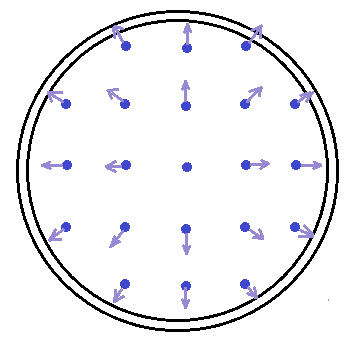

  • #64
The below animation shows all that is needed to know about induction to prove my point about cutting the lines is the only thing that sets up a current in a conductor in a magnetic field. The action starts in the video at about 32 seconds. If we cannot nail this part down and agree then this discussion is doomed. Keep in mind that the motion only needs to be relative. An increasing or decreasing field with the right orientation of the conductors relative to the flux will cause a current in the conductor. Conversely, an increasing or decreasing field with the conductors oriented in a different way will not cause a current in the conductor.
https://www.pengky.cn/zz-generator-...lternator-principle/alternator-principle.html
  • #65
Ahh, now I see what you meant. Thanks for posting this. This view of induction IS correct when you have a FIXED (unchanging in magnitude or direction) magnetic field, and MOVING wire components in the B-field. The emf is caused by the magnetic part of the Lorentz force:

  • #68
Ok so let's look at this another way. We agree (I think) that a completely shorted ring will read zero volts no matter how the pie shaped probes are positioned. A ring that is not shorted shows a voltage that varies depending on the position. Your claim is that in the case of the varying voltage, we are not reading a voltage that is present from point A to point B. We are reading a voltage generated by the loop that is formed by the pie shaped probes and a portion of the ring. Suppose I give you the benefit of the doubt here and agree to that. So how can you explain the zero volts scenario with a shorted ring? You can't have it both ways. We still have the pie loop and still have the same field and it is NOT generating a voltage.
  • #69

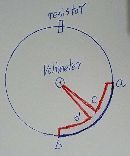

alan123hk said:
I think the test method used by mabilde is correct. When we measure voltage with a voltmeter, the DUT has to supply energy, so the Lewin circuit has to supply energy, so the voltmeter loop has to somehow let the changing magnetic flux through to get the energy, otherwise it won't be able to measure anything thing.
Of course, according to Faraday's law, the test result is the induced EMF in the pie-shaped area due to the change of the passing magnetic flux. But this is not enough to prove that it cannot represent the scalar potential difference generated between the ring arcs at the same time.
I think whether you agree or disagree, both parties should try to come up with some stronger arguments to support it. The method you said of pressing the leads together so that the loop becomes a closed T-shape with no area is problematic because the leads of the voltmeter will be affected by the induced electric field. When you're trying to measure the potential difference created by a pure charge, you can't subject the voltmeter and its leads to an induced electric field.
I reiterate my opinion again, I agree with mabilde's method is correct.
[Sorry, what is the DUT?]
Ok, so you agree that the pie shaped measurement loop is penetrated by the corresponding part of the solenoid flux, and this emf is what the voltmeter reads per Faraday's law. I think where our thinking differs, is what the intended measurement is. As we've discussed, we have two different voltage conventions:
Path voltage = Int(E . dl) (between two points on a specified path.)
Scalar potential = Int(Es . dl)
where I'm using E as the total electric field (which charge actually responds to), and Es is the electric field from the only the static charge distribution, or the static field. I'm going to stick to this terminology to keep the two conventions separate. In the case of a battery providing the emf, there's no difference. With induced emf, these are different quantities.
With direct measurement (no flux in the measurement loop), a voltmeter can only measure path voltage, as it is the actual energy difference per unit charge between two points, or looked at another way, the work per unit charge done by an outside force moving a test charge along the path. Put a voltmeter across a resistor, you get the V in V = IR. Put one across conducting wire, you get zero.
So if @mabilde is using the scalar potential convention for voltage (he never explicitly says so but he does cite the McDonald paper so I can only assume that's what he means), he cannot measure it directly. Scalar potential (as I understand it) is a mathematically derived value, not an observable physical phenomenon, as you cannot extract the static field from the net field outside of an equation.
Now I agree that if the resistors are of negligible length, and in this precise circular setup with the leads positioned exactly as they are, that the scalar potential difference across a section of conducting wire is numerically equivalent to the induced emf through his measurement loop. So if the flux emf is .25V, we can say the difference in scalar potential is the same.
My problem is that he doesn't mention scalar potential, discuss the difference in voltage conventions, or acknowledge that he's really just measuring the flux through his loop. As @rude man said in one of his posts, @mabilde is 'simulating' the scalar potential measurement, not measuring it directly. Well I can 'simulate' rain by pissing on your leg. And if say "please enjoy this rain simulation", there's no problem. But if I tell you it's raining, most people would call that lying. Either way it creates a mess. The point is that he's convinced people that there is a measurable energy drop that exists between two points of conducting wire, which is completely bogus. (I'll answer the second part about the voltmeter leads canceling the 'emf' in a separate reply).

Thanks for the clarification on the shorted ring. We could take that to be a string of identical resistors as in the video, a ring of uniform resistance, or single loop of conducting wire (with no other lumped resistors). I certainly do NOT agree that the correct measured voltage (meaning path voltage, IR drop, etc) is zero between any two points, as the emf is now evenly distributed across the ring, as opposed to conducting wire with a lumped resistor in it, where all the voltage drop is across the resistor.
However Mabilde DOES measure zero in his flux-influenced setup, as the resistor drop is canceled by the flux emf through his leads at all points. Now the scalar potential, the mathematical concept he's trying to measure, IS essentially zero between any two points as static charge does not build up anywhere. But he can't measure it directly so he uses the flux through his loop to give him the same thing.
So what should the 'path voltage' drop (as in V = IR) be? First setup your voltmeter correctly. Best to put it outside the wire circle in such a way that no flux enters your measurement loop. Put your leads around say, a 90 degree section, and you'll measure 1/4 of the total emf. This represents the physical energy drop per unit charge along this shorter, direct path. If you use P = IV this measurement will correspond to the real, measurable power dissipation (heat) in this quarter section of the ring.
But why doesn't this give you the 3/4 voltage drop instead? How does the voltmeter 'know' which path you want to measure? Because THIS loop is flux-free. If you analyze the path along the long way, going through the 3/4 loop section, it's obvious that this loop has the ENTIRE flux/emf passing through the loop, which affects the measurements accordingly. Working out the math, you'll see that the 3/4 voltage drop, MINUS the emf induced by the flux (and a sign flip accounting for lead placement), gives you the same 1/4 drop:
-(3/4 emf -1 emf) = 1/4 emf
Both analysis paths are completely consistent. If you want to measure the 3/4 drop directly, just cross your voltmeter on the other side of the flux. Now you have a flux-free loop with the leads around the 3/4 section, and you'll measure 3/4 of the total emf, which corresponds to the V = IR in this section.
This is the non-0V, paradox-free solution I promised you. Voltmeters only measure the section of the ring corresponding to a flux-fee loop. If you can understand this thought experiment, you will understand Lewin's circuit completely, as it's pretty much the same thing. Faraday's law always wins.

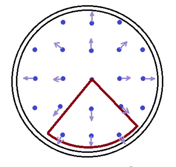

I promise I will address the lead placement 'error' in a different reply to keep these from getting too long. And your shorted battery loop example, as you describe it, makes perfect sense to me. No disagreement. But for now,
LET'S TALK ABOUT ENERGY
I'm sure you know this but I will spell it out so we can make comparisons. A battery is a device that stores chemical energy. This energy comes from ... chemical reactions ... (my chem is not great). But I do know that this stored energy does work to separate charge, from neutral to a split positive / negative pair at the terminals. That's about as far as I need to understand the internal workings. So the battery does the work of separating charge, depositing this charge it's terminals. It now acts like a capacitor, but one whose charge, and therefore potential difference never changes. I think of this as a replenishing capacitor. It's important to remember the electric field INSIDE the battery, just like a capacitor, points from positive to negative - this negative field is a record of the work the battery had to do to separate the charge.
The battery has now converted chemical energy to electrical energy, or emf (voltage). The emf of the battery is the sum of the electric field throughout the rest of circuit, from positive terminal to negative terminal, in the direction of current. Attached to a resistive wire, this emf is delivered to the wire uniformly, with uniform electric field everywhere. If the resistors are lumped, charge distributions form at the resistor ends which redistribute the electric field, concentrating the field ONLY IN THE RESISTORS and leaving conducting wire with no field. The electric field in the resistors represent a record of the energy they receive from the battery. This energy is then dissipated, but we don't count this twice - we only count what the resistors receive. So battery does the hard of work of mining chemical energy, and gives this energy to the freeloading resistors to spend how they like. The zero-sum electric field is a record of this internal transaction. And the transaction will continue for as long as the battery has stored energy.
So now we have good old fashioned Kirchoff's law, in both voltage and field form:
Sum(V) around loop = 0
Int(E.dl) = 0
Here energy was both created and spent WITHIN the loop. Again it doesn't matter if we use lumped or distributed resistance.
Now let's talk about the induced emf case. The changing flux of the solenoid CREATES an electric field throughout space, which interacts with the free charge in the circuit. The integral of this field in the circuit loop is the emf. Just like the battery, the electric field is concentrated only in the resistors, or uniformly spread in the case of resistive wire. How does this field simply arise from nothing? The same way you can turn on your TV with a remote - it's an electromagnetic wave that propagates from the solenoid radially outward until it hits something, traveling at the speed of light. How does it deliver energy? The same way you feel warm sunlight coming from a source 93 million miles away. The field contains energy and can transfer it from one place to another. From the point of view of the loop, this is FREE ENERGY.
The electric field in the resistors still point in the direction of current, but there is no record of any work done (like a battery). There is no negative field to cancel out the positive. This loop must worship the solenoid like a god, as all it does is give out free energy. It never has to do any work, and its balance sheet (the electric field, or some of voltage drops) only shows income. Where does the energy REALLY come from? Lot's of sources, but imagine some guy pushing a bar magnet back and forth through the solenoid. He feels a force - not just the inertial force but a magnetic force on his bar, so he's doing work the whole time until he gets tired and runs out of his stored energy. He has replaced the battery, and he is certainly not part of the loop. So conservation of energy works out, but now we need to account for it differently:
Int(E.dl) = -d(phi)/dt
or Sum(V) around loop = -d(phi)/dt.
Another way to think of Faraday's law:
Sum(V) = work done by the guy pushing the magnet, per coloumb.
