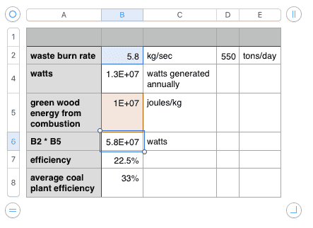

I needed an easily solved homework problem this morning.
Source of data: https://www.co.marion.or.us/PW/ES/disposal/Pages/mcwef.aspx
