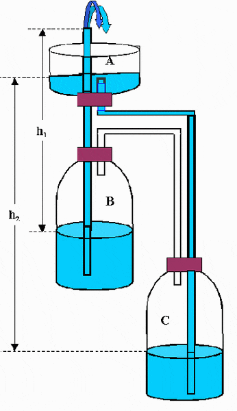

- There is a tube of air leading from one container to another. If I increase the tube length how will this affect pressure.
- There is a container of water which a tube connects from here to another container (vertically), air pressure will increase in the container (as air is pumped in there) causing the water to flow up a vertical tube. How will the length of this tube affect the velocity of the water in the tube (basically how affects pressure that causes the water to move up the tube).
That isn't a diagram. Please provide a diagram.

Physicist1011 said:
Ok, so there is no way I could have understood that from the description. This is just a complicated siphon and the length of the air tubes don't matter except that the pressure in them is determined by the height of the water tubes and reservoirs.
... and no, it will not give you a perpetual motion device ...
I am not talking about the water reservoirs. I don't understand whether the length of the tubes affect the velocity of the water in tube from B to A.
Before it was said that it does not matter because the pressure causes a force which cancels out friction and weight forces.
In general longer pipes will have more friction loss, but which pipe are you referring to? For example, if you lower tank C, the flow rate will increase.
The question that I'd heard and answered was whether the length of the tube affected the difference between inlet velocity and outlet velocity. It does not. That's not the same as asking whether it affects velocity.
