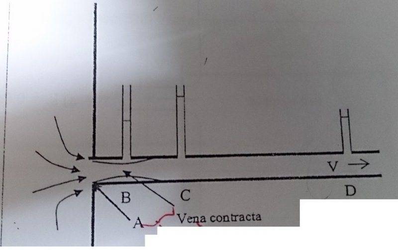

I was told that for loss of head at entrance , the degree of contaction depends on how thick the pipe walls is .
i really don't know the meaning , can someone clarify ? the author also stated that the loss coefficients will vary , for very thin tubes , k is very high ?
head loss = k (V^2) / 2g
as we can see , the haed loss is affected by velocity of water , how can thickness of pipe affect the head loss? [/B]

Can you provide an exact quote?

The degree of contraction depends upon how far the flow the pipe may project within the reservior and also how thick the pipe walls are , compared with its diameter

Can you provide a diagram?

  • Hand-drawn diagram of fluid flowing from a reservoir into a horizontal pipe with a sharp-edged entrance, showing streamlines converging at the inlet, a vena contracta marked, labelled points A, B, C and D, velocity V pointing right, and vertical piezometer tubes along the pipe.

What are you trying to say?
