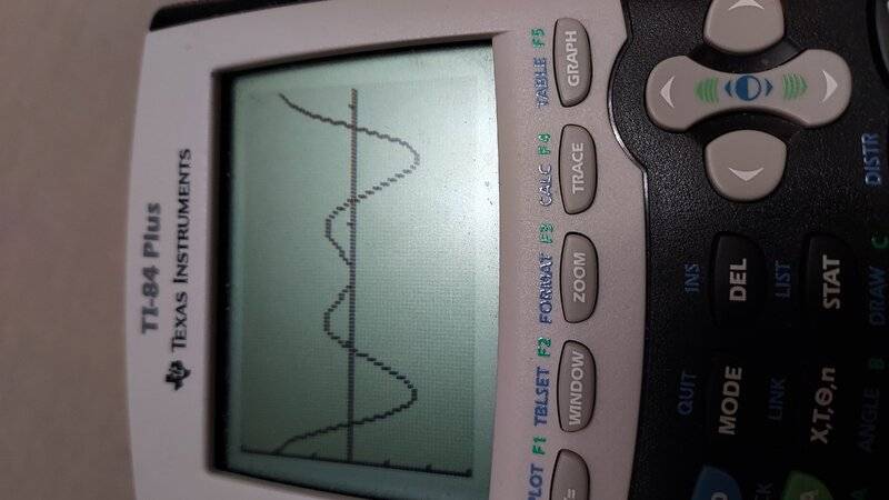

Thank you, TSny and haruspex. Very helpful. So I converted revolutions per second to radians per second. Then Omega1=.525 rad/s and Omega2=59.165 rad/s. Putting the function with these values into my graphing calculator (with an x window of 0 to 30 seconds), there are peaks at at 0 seconds and 30 seconds, so the period should be 30 seconds.
Now, to answer haruspex's question, if we count both peaks as part of the cycle, then the beats would occur every 15 seconds. But it doesn't make sense to count both beats as part of the cycle, because we had to wait 30 seconds to hear the second beat, not 15 seconds. So my answer is that we hear a beat every 30 seconds, while the book answer key says every 6 seconds.

OK, except that the cos(.525t) part of the function equals 1 or -1 fives times in 30 seconds, not twice. This is consistent with the book's answer because 30 seconds divided by 5 equals 6 seconds. However, I am confused by the graph. If I display the whole function and the cos(.525t) part on the same graph, the extrema only coincide twice (at t=0 and t=24) and appear to be only approximately correlated the other three times.
Also, haruspex said previously that you could find the period just by solving cos(.525t)=2pi. But that gives us 4.8 i, while the period as seen in a graphing calculator is 12 seconds. Why the discrepancy?

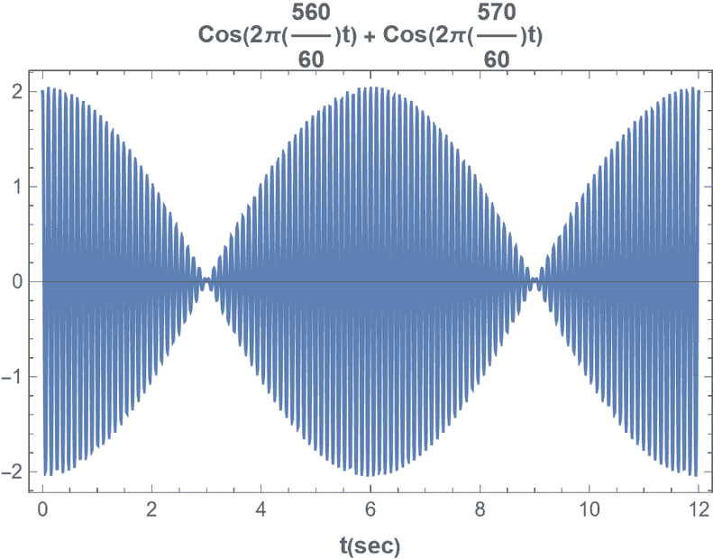

Perhaps the low-resolution of the calculator graph is confusing you? Here's a more detailed plot:
Yes, the resolution is what threw me off. Thank you.
