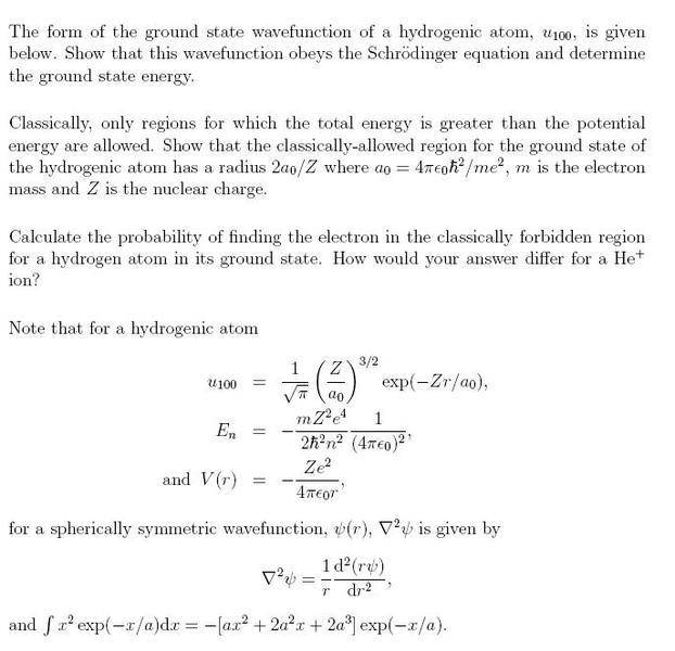

hhhmortal
175
I've attached my past paper question, which contains the relevant integral identity too.
This question is relatively simple, yet I can't seem to complete it.
I used the Schrödinger equation which is:
-(ħ²/2m)[tex]\nabla^2[/tex]u + Vu = Eu
I then used the identity given in the question, to differentiate the wavefunction w.r.t to r twice. (In this part I had to differentiate by products since there was another factor of r).
Differentiating the wavefunction twice gave me:
(Z²/a²).r.u
When I put this into the Schrödinger equation above, knowing V and E, I don't get the correct answer.
I forgot to say, that it's the first part of the question which I'm having trouble with.Thanks.
  • Typed physics problem text with equations: the ground state wavefunction u100 of a hydrogenic atom, u100 = (1/sqrt(pi)) (Z/a0)^(3/2) exp(-Zr/a0), with energy En = -mZ^2 e^4 / (2 hbar^2 n^2 (4 pi eps0)^2) and V(r) = -Ze^2/(4 pi eps0 r).

Can't tell you where you go wrong since you barely show any work, but I can tell you two things.
1) Your Schrödinger equation is incorrect.
2) You differentiated the wave function twice incorrectly.
I've fixed that now. I differentiated the wavefunction using the product rule:
using the identity given in the question, I had:
d²/dr²[ r. exp(-Zr/a)] Is this what I need to differentiate?
Out of interest, how would one go about solving the third part of this question?
