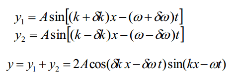

Am I suppose to superimpose the following waves:
exp i(kx - wt) + exp i((k+Δk)x - w't)
whereby the other wave has a different wavelength such that k becomes k+Δk and w becomes w' (with k+Δk) ?

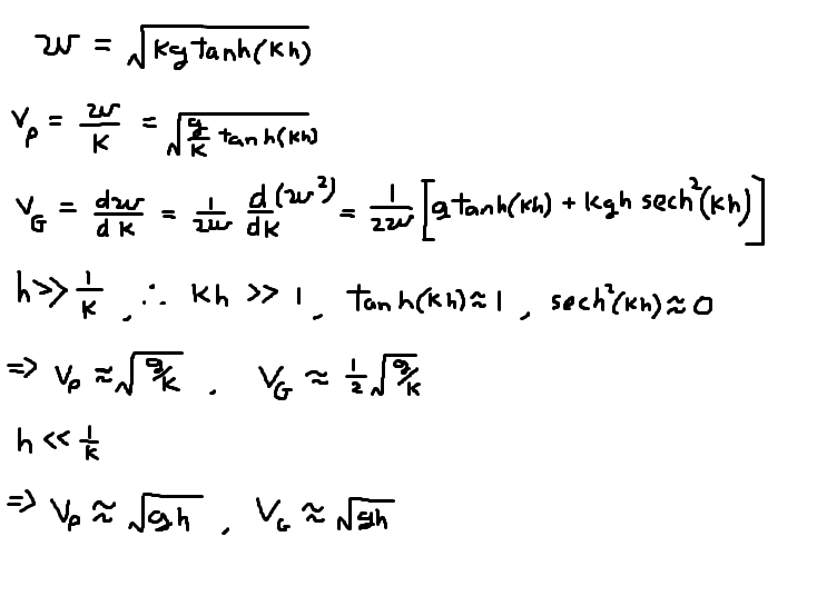

So I found that at h >> 1/k or h >> λ/2∏
vg = (1/2) vg
And at h << 1/k or h << λ/2∏

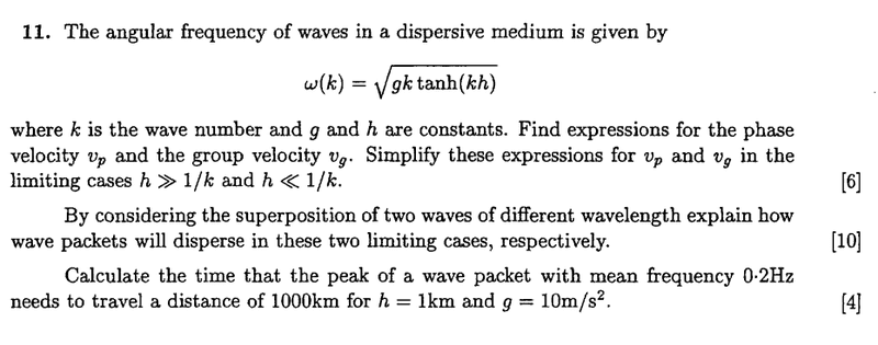

vg ≈ vpI first assume that h >> 1/k or h >> λ/(2∏): But how do i prove this? I can't seem to solve the tanh function to find the value of k..
I got:
0.16≈k*tanh(1000k)
If i assume k≈0.16 since tanh(160) ≈ 1..
i get vp = 7.9m/s
Time taken = 35 hours..
