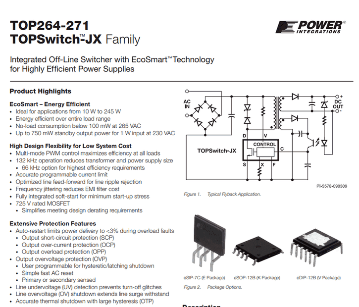

What are the ways to test a switching IC like TOP266EG with a multimeter?
What are the ways to test a switching IC TOP266EG with a multimeter?(measuring it outside of card circuit)(after uninstalling the component from the card)
Link to the datasheet: TOP266EG Datasheet(PDF) - Power Integrations, Inc. (alldatasheet.com)

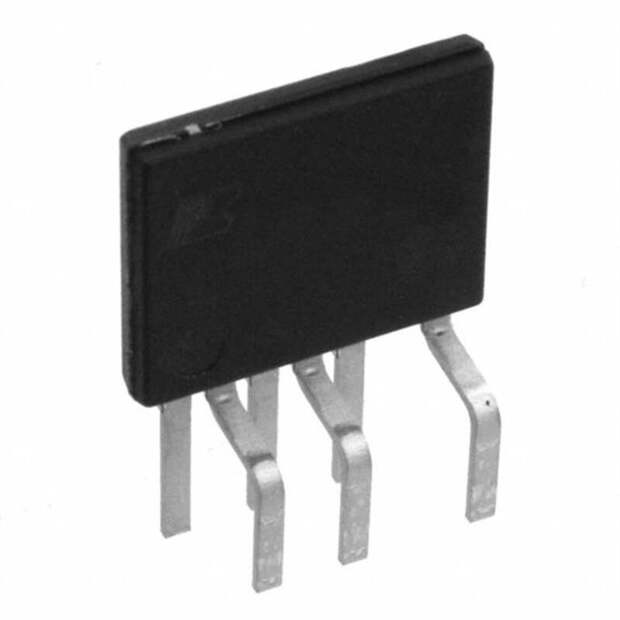

Here is the DATASHEET picture:
TOP266EG IC HAS THE SAME APPEARENCE
What do you mean by "test"? You have a PC board with this circuitry on it and it's not working and you want to troubleshoot it? Or you have the loose IC and want to know some way to tell if it's okay or not?
loose IC, yes
"Or you have the loose IC and want to know some way to tell if it's okay or not?"
this, yes.
