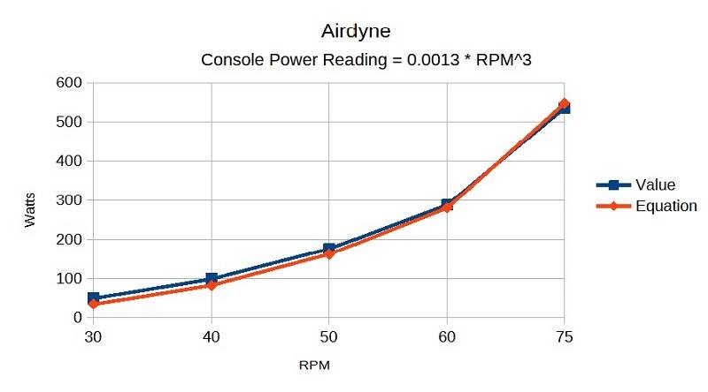

When analyzing an airdyne exercise bike, it's best to start with the physics by listing possible sources of resistance to pedaling.
1) Fan power is proportional to RPM^3. This is a basic fan law.
2) Possible friction that is constant at all speeds. This would show up as power proportional to RPM.
3) Possible viscous friction. Viscous friction torque would be proportional to RPM, so the power would be proportional to RPM^2.
These bikes turn easily with light force on the pedals, so start by assuming that 100% of the pedal power is used to spin the fan against air resistance with the other two sources negligibly small. Start by fitting a cubic curve to the console power readings. The best fit curve has the equation ##Watts = 0.0013 * RPM^3##. The resulting curve, along with the original data, is shown plotted below.

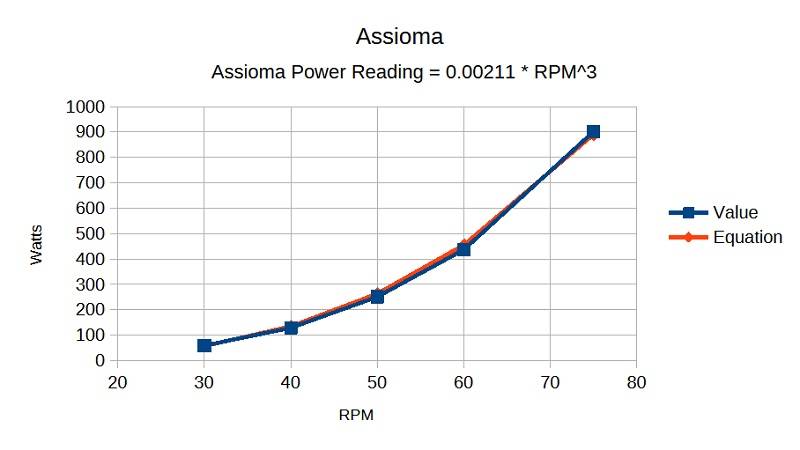

The equation closely follows the console readings, with a small linear difference. Next, do the same with the Assioma pedal outputs. That best fit cubic curve is ##Watts = 0.00211 * RPM^3##. Plotting the Assioma data with the Assioma best fit cubic curve results in the following:
While both equations follow their data well, the Assioma equation follows the Assioma data with less error. The Assioma readings are based on strain gaged pedals, so originate with direct measurements of torque and RPM. The Airdyne readings are apparently based on a factory calibration curve because they closely follow the predicted cubic trend. The difference between the two sets of measurement can be explained by a large calibration error in the airdyne readings. You can test this by fastening cardboard disks to both sides of the airdyne fan, then repeating the test. The cardboard disks should reduce the power at all speeds. The Assioma readings should show less power at each RPM, while the Airdyne readings would be expected to be the same as the readings without the cardboard.
Good graphs. If this extra pushing contributes independently to the fan’s cubic power, it would explain this. If you double the fan speed, force quadruples, and the other viscous? force doubles: the result would be eight times the force and sixteen times the power: in line with the results I was getting on the Assioma pedals. (Magnetically braked cycles also exhibit quadratic power, which would result in the third term being cubic instead.) Seems that the pure math that I brought to the table reflected the interplay between two separate forces that, together, were acting like one quartic force. This extra added force must be generated by the jerky pedaling motion of the human pedaling power curve.
My Assioma power pedals were calibrated and tested against a good Zwift trainer and its numbers are accurate to within 2% or so. The Airdyne was calibrated at the factory using a 20 hp motor attached to the drive train, and it spun the whole engine (chain, cogs, cranks, and fan). I don’t have access to this kind of testing equipment, so I verified things another way: using only my arms, I pulled as hard as I could on the arms of a Schwinn Evolution Comp (no longer available) that was certified accurate enough (within 2%) for medical use: I sustained 63 RPM (200 watts) for 90 seconds. Forty eight hours later, I tried to see how many strokes I could do in 90 seconds on my Northern Lights Airforce Bike: 54 RPM (216 watts). Close enough. By using my arms, I could keep constant tension throughout the range of motion of the arms of the cycle. There was only a very small fraction of a second of deadtime during which the arms switched directions, which greatly reduced the size of the ‘quartic’ terms. I also tried fan dampening and observed a reduction in the power output on the Assioma pedals.
Looks like my pedals are working properly and they’re not pulling my legs (pun intended).
