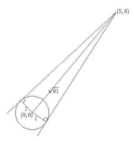

If the line is tangent to x2+y2=1 at the point (5,6), then what do you know about the line's slope?
Think about that one again.
here's the situation
http://img43.imageshack.us/img43/6778/twolines.jpg

Ah ha, tricky. I misinterpreted the question :redface: Nice catch Office Shredder :smile:

Consider one of the tangents and draw the following lines
point (5,6) to centre of circle
point(56) to tangent where it meets circle
centre of circle to tangent point
You now have a right angled triangle and you can take it from there

Except that the gradient you want for the line is not any of the angles in that triangle. You can do it from there, but it will involve more triangles. In the end you should get equations similar to those that have been identified in the thread.

Your rectangles have a vertex lying on the circle, but it is not at the tangent point. This leads to the wrong answer, though the difference is small.
If you think about the rightangle triangle described by DadFace, the hypotenuse is of length sqrt(61), and so the length of the line from (5,6) to the tangent point will be sqrt(60), not sqrt(62). (I have attached a diagram.) The angle between the line (0,0)-(5,6) and the tangent lines is atan(1/sqrt(60)).
I used the inverse cosine of (sqrt(61)/sqrt(62)) to find the angle that the diagonal line makes with the very first line I drew. This angle was about 7.2962 degrees. I next took the inverse cosine of 5/sqrt(61) to find the angle the first line that was drawn makes with the line parallel to y=0. I found this able to be about 50.1944. I added the two angles next. This left me with about 57.4906 degrees.
Your value, of 7.2962 degrees, is atan(1/sqrt(61)), or asin(1/sqrt(62)), but that's not the angle you want. Your value of 50.1944 degrees for the line from (0,0) to (5,6) is fine.
You're close, but you've basically missed the tangent point.
Try again, using Dadface's triangles rather than the rectangles. Everything else is okay. You'll get an angle something close to what you had before, a bit over 7 degrees.
