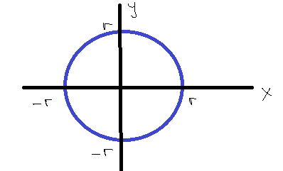

A solid cylinder of radius r and height h is cut by a plane which passes through a diameter of the base and intersects the cylinder's top in just one point, cutting the cylinder into two parts. Calculate the volume of the smaller part
Integration
I imagine the shape will be like this:
and I need to find the volume of the shaded part. I am planning to use: ##V=\int A(y) dy##
I tried to take the cross-sectional area A(y) to be triangle:
and the base of the cylinder to be:
So it means that the base of the triangle will fulfill the equation of circle ##x^2+y^2=r^2## and the base will be ##x=\sqrt{r^2-y^2}##.
But I can't find the equation for the height of triangle. I imagine that the height will satisfy maybe equation of tilted parabola and I don't know how to find it.
Is my approach correct? Or maybe there is better method to do this question?
Thanks

What is the equation of the plane? What does this mean for when ##x = \sqrt{R^2 - y^2}##?
That being said, I would have used the circle segment slices instead.
Edit: Actually, your slicing does result in nicer integrals. Keep doing it, just keep the above in mind. (Luckily, the result is the same)

I think I get your hint and I got the volume to be ##\frac{2}{3}r^2h##
Is this correct? Thanks
It is the same result as I obtained in both ways.
