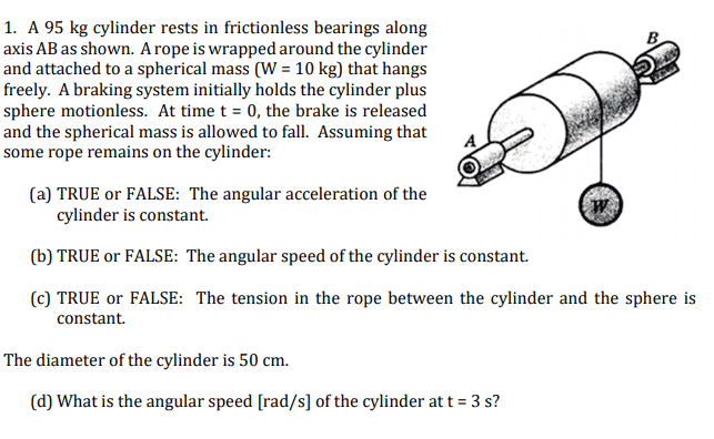

Hey guys, so I am a little stumped on this problem. Can y'all help?
I think for a) it is true but am not sure
For b) I believe is is false because the angular acceleration would cause the angular speed to increase
For c) I think it is true since acceleration is constant so T=ma is constant
Does that sound right?
For part D, I know these equations but am not sure:
Sum of forces=mv^2/r=m*omega^2*r
Thanks

Your answers are correct, though I don't know what you mean by "T=ma".
Those equations describe circular motion and centripetal acceleration. You won't need them here.
Instead, analyze the forces on the cylinder (and the torque they produce) and apply Newton's 2nd law for rotation. Also analyze the forces acting on the hanging mass and apply Newton's 2nd law to it. That, with a bit of work, will allow you to calculate the acceleration of both the cylinder and the hanging mass. (Note: The angular acceleration of the cylinder and the linear acceleration of the mass are related.)

I think only one force is being applied on the cylinder, right? The force from the rope? And the force in the rope is mg. So does that mean the angular acceleration is equal to g/r. We can then use angular kinetics equations to find the angular velocity?

Where m is the suspended mass and a its acceleration? No. The sum of all the forces is ma.
Yes, but consider torque.
It is that before the brake is released, but not afterwards. This will become clear when you get the ΣF=ma equation right for the suspended mass.

Ok. Thank you for your help. So the torque applied on the cylinder is f*r, where f is the force applied by the rope. I am not sure how to relate torque to sum(F)=ma.
Edit: would I need to use the moment of inertia?
Edit 2: would you have mass of spherical mass*g*R=.5*mass of cylinder*R^2*angular acceleration?
And then you can take that and have angular speed=angular acceleration*time? and then angular speed*r =velocity?

Forget the cylinder for the moment and fix on the suspended mass. Write the equation for its resulting acceleration.

Is it tension in rope/mass of spherical mass?
No.
What are the forces acting on the mass?

Gravity, the tension in the rope? And the cylinder spinning?
The mass doesn't know anything about the cylinder. It only responds to the forces directly applied to it, the tension and gravity.
So what is the sum of the vertical forces on it, and how does that relate to the acceleration?

-mg+tension=ma
So a=(T-mg)/m
nerdeagle24 said:
mg+tension=ma
Right, but they act on opposite directions, of course.
Now consider the cylinder. For this you need the rotational analogue, i.e. that the net torque is the moment of inertia multiplied by the angular acceleration: Στ=Iα.

so we get tension*R=I*angular frequency?

Careful with signs. Which way are you taking as positive for a, up or down?
I am saying up is positive a
Angular acceleration, not angular velocity.

So we have two equations but three unknowns (angular acceleration, tension, acceleration of mass)? What else should I look at?
The angular and linear accelerations are directly related.
Oh ya. So angular acceleration=a/R.

I ended up with angular acceleration = (mass cylinder*R/2*mass weight+g)/R
Is that right?
That makes no sense dimensionally. Please post your working.
I realized I made a mistake:
So my equations are:
angular acceleration = a/r
.5MR^2=T*R
mg-T=ma where a is defined as down
So we get from the third equation:
T=m(g-a)
and the second equation:
T=.5MR
Set these equal to each other and solve for a:
a = g-(MR/2m) where big M is mass of cylinder, little m is mass of sphere
So then angular acceleration = (g-(MR/2m))/R
plugging in numbers we get 14.87 rads/sec^2
So angular speed = 14.87*t=14.87*3=44.61 rads/s
This doesn't feel right as that is a really high speed
I see another mistake. I am sorry.
.5MR^2*angular acceleration=T*R
T = m(g-(angular acceleration/R))
Plug in second equation and solve for angular acceleration = (.5MR+(m/R))/mg
You need to learn to check dimensionality. What would be the dimensions of angular acceleration/R?
