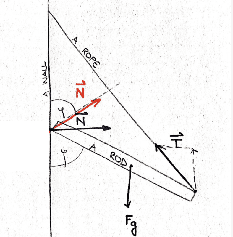

What is the force of a wall on a revolvable rod?
II. Newton Law, Free-Body Diagram
I have a dilemma.
If I look at the diagram and say the sum of the forces in x and y direction has to be zero, then I will simply conclude that the force of a wall on a revolvable rod is the blue N as drawn.
But what if the force is actually the green N? To me, it makes more sense because if imagine no tension and no mass M, then the force of a wall N would be drawn as below (green N).
So how can I argue that the orange component of N does exist? If it exists...

Yes, the rod is hinged at point A.
If there were no hinge and the friction coefficient would be low, then I would conclude that the only force of a wall acting on a rod is perpendicular to a wall ------> blue N.
But this example poses a doubt: the situation is almost similar, only in this case the rod is directed downwards.
In this case the red N is correct (from the solution manual ).
But why? Is maybe the official solution wrong?

Note that there are just three forces on the rod. If the net torque is zero, the lines of action of the three must pass through a single point. (Do you see why?) You can use this to make more accurate diagrams.

The correct solution here as well is the dark blue N, because all forces have to cancel out in the diagram.
I was confused because there was a mistake in solution manual and I wanted to be sure if I understand the normal force acting on the rod.

In the situation in the diagrams in posts #5 and #12, you cannot instantly say whether there is a vertical component to the reaction from the wall, nor in which direction it might be if there is one.
As I noted in post #11, for stasis, the three forces must act through a common point. Take the horizontal from the point of contact with the wall and the vertical through the mass centre and see where they intersect. If they intersect below the wire then the tension would exert an unbalanced anticlockwise torque on the rod, so there must be a vertically upward force from the wall; if they intersect above the wire then the force from the wall must have a downward component.
Going back to the diagram in post #1, there is the complication of the mass M. But we can combine the two weights into a single downward force somewhere between the two. Clearly this intersects the horizontal well below the wire, so there has to be a vertically upward component to the reaction from the wall.
