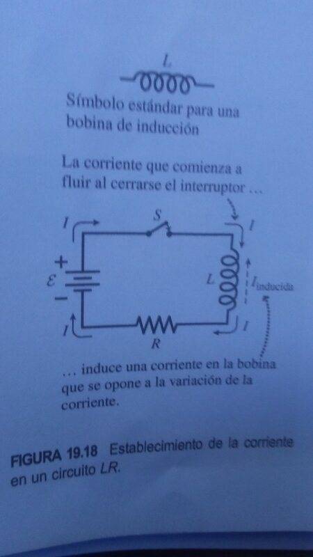

Hi
I've attached the image of the circuit. My first thought before connecting it: if I connect it, I must consider the fact that current cannot circulate suddenly, because a sudden change in the amount of current should imply an infinite value in [tex]\dfrac{\Delta{I}}{\Delta{t}}[/tex], and a infinite e.m.f. Instead, the current increases steadily, the e.m.f opposing to that increase. The battery makes a work against emf of the coil; at the end, the current achieves it's final value. The work required to establish a current [tex]I[/tex] in a coil is [tex]\dfrac{1}{2}LI^2[/tex].
Which are the maths beside [tex]\dfrac{\Delta{I}}{\Delta{t}}=\infty[/tex]?

I'm not sure what your question is?
The equations for this circuit are the Kirchoff Voltage Law, the voltage across the inductor and the resistor must add up to the battery voltage (after the switch is closed). These voltages can be expressed as a function of the current flowing around the circuit, which is the same for all components.
So: E = L⋅(di/dt) + i⋅R after the switch is closed. Normal initial conditions are i(0) = 0.
di/dt is essentailly the same as Δi/Δt when the Δ is very small.

Sorry, I think I've used the wrong notation, and the wrong question: Why does point out [tex]\dfrac{\Delta{I}}{\Delta{t}}\rightarrow{+\infty}[/tex] if nothing worked as you mention?
Hum... I'm not sure why it says that.
The Inductor voltage Vl = L⋅(Δi/Δt). If Δi/Δt → ∞, then Vl → ∞. Theoretically this could happen if there was current flowing and you opened the switch. I guess their point is that the inductor current can't change instantly because that would require an infinite voltage, which is true.
BTW, mathematically this is the same thing as saying the voltage on a perfect capacitor can't change instantly because it would require infinite current.
This is the fundamental nature of these circuit elements.
edit: It's also similar to saying you can't stop a moving object instantly because that would require infinite force.
