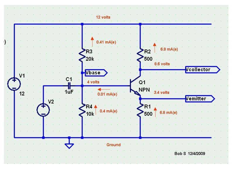

How about you show us some effort here. What exactly are you asking about? What is the context of your questions? Is this for schoolwork? What did you think of the great information links that you were given above?
i want a detailed note on bjt biasing
Well, what kind of questions do you have on transistor biasing?

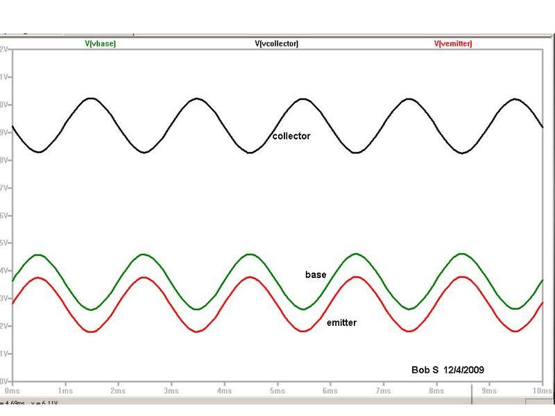

See my two attachments in post #3 for a npn BJT biasing example.
