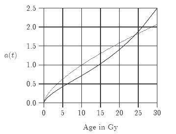

Jon, now you have exposed the "sins of my youth", forcing me to defend what I wrote!:smile:
I wrote that in order to explain the curves (attached, for Ho=64 Km/s/Mpc, Omega = 1, Omega_v = 0.7 for the bold curve, Omega_v = 0 for the 'dotted' curve). The mention of "the inflationary epoch 'delivered' a universe with the expansion rate precisely balanced with the amount of matter" together with "So during early years, when there was negligible vacuum effect, the amount of matter to be balanced by expansion rate must have been less in the same proportion" was perhaps confusing. It is certainly true for the "early years", but even the very coarse timescale of the attached curves indicate that the slopes converge at very early stages.
Given Ho, a detailed early epoch integration shows that at decoupling (z~1100), there was ~ 50% difference in expansion rate between a flat radiation + matter universe and a flat LCDM universe. At t ~ 1 year, there was only ~ 1% difference, diminishing to virtually no difference at t ~ 10 seconds. The reason for this is the dominance of radiation energy density at the very early epochs, which you cannot ignore. (I have a suspicion that is what you did?)
