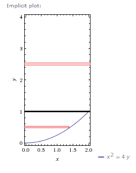

The region in the first quadrant bounded by the lines y=4 and x=2 and the curve x^2=4y is revolved about the y-axis. Find the volume:
a) by the method of washers
b) by the method of shells
I drew the region, and I can picture what the solid volume would look like. I think the limits of the integral are 0 and 4, if I'm not mistaken. Also, for the washer method, I need the inner and outer radius. I think the outer radius is x^2/4, but I'm not sure what the inner radius would be. As for the shell method, I think the radius would be 4 and the height, I'm not so sure about. Any help is appreciated. Thank you so much.

For the washer method, the radius [itex]R(y)[/itex] is given by
[tex]R(y) =<br /> \left \{<br /> \begin{array}{lr}<br /> 2\sqrt{y} , & 0 < y < 1\\<br /> 2 , & 1 < y < 4<br /> \end{array}<br /> \right.[/tex]
Because the radius is a piece-wise function, two integrals must be evaluated to find the volume.
For the shell method, the radius [itex]p(x)[/itex] is given by [itex]p(x) = x[/itex] and the height [itex]h(x)[/itex] is given by [itex]h(x) = 4 - \dfrac{x^2}{4}[/itex].
After you review the washer and shell methods, you should be able to progress from here.

I attached a graphic to aid our discussion. The black line at [itex]y = 1[/itex] appropriately divides the graph into two regions, one below the line and one above the line. In each region, an arbitrary radius is represented by a red rectangle. In the lower region where [itex]0 < y < 1[/itex], the radius [itex]R(y)[/itex] is given by [itex]R(y) = 2\sqrt{y}[/itex] as you already know. In the upper region where [itex]1 < y < 4[/itex], what is the radius [itex]R(y)[/itex]? From the attached graphic, it should be clear [itex]R(y)[/itex] is constant in this region.
  • Implicit plot over x from 0 to 2 and y from 0 to 4 of the parabola x^2 = 4y, with a thick horizontal line at y = 1 and short red horizontal segments near y = 0.5 and y = 2.5.
Thank you so much. The graph really helped me understand it better.
