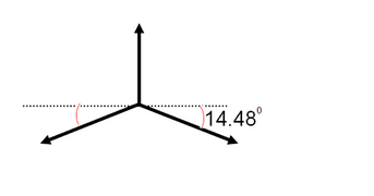

A rocket ship parked at rest in space suddenly explodes into 3 pieces of equal mass traveling in the directions shown. If the piece traveling upward has a speed of 150 m/s, what are the speeds of the other two pieces?
How do I conserve the momentum in this case? I'm clueless.

I think you mean conserve momentum.
Can you say anything about horizontal momentum?
Write momentum equations for the three pieces in x and y. The assumption is that there is no z motion.
