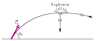

A shell is shot with an initial velocity Vo of 22 m/s, at an angle of θ = 59° with the horizontal. At the top of the trajectory, the shell explodes into two fragments of equal mass (see the figure). One fragment, whose speed immediately after the explosion is zero, falls vertically. How far from the gun does the other fragment land, assuming that the terrain is level and that air drag is negligible?

Okay so the first thing I did was was find the height of the apex. I found this by finding the x and y components of Vo:
Vox = VoCos(θ) = 22cos(59) = 11.33 m/s
Voy = VoSin(θ) = 22sin(59) = 18.86 m/s
Using the initial velocity of the y component I found the time it took to reach the apex:
t = -Voy / ay = -18.86/-9.8 = 1.93 s
Using the time I found the height of the apex:
Δy = Voyt + (1/2)ayt^2 = 18.86(1.93) + (1/2)(-9.8)(1.93^2) = 18.15 m
Using the height I found the time it took after the explosion for the bullet fragment to reach the ground. Because the bullet was at the apex, the initial velocity of the fragments is zero in the y direction
t = √(Δy/(1/2ay)) = √[(-18.15)/((1/2)(-9.8))] = 1.94s
Using the momentum equation I was able to find the initial velocity of the bullet fragment in the x direction:
Pi = Pf; 22m = (1/2)mVo; Vo = 44
Finally using the two times and two speeds of the fragment in the x direction I found (wrong according to the website) the total distance:
Δx = (Vox * t) + (Vox * t) = (11.33)(1.93) + (44)(1.94) = 107.23 m
What is the initial velocity in the x-direction?
Before the collision the initial velocity is 11.33 m/s. Then treating the explosion as a separate event, I made the initial velocity in the x direction of the gun fragment 44 m/s.

I just realized I used Vo not Vox for the momentum in the x direction. I will try with that next. But I want to make sure my thinking on this is correct. The initial momentum must equal the final momentum (pi = pf) where
pi = 11.33m and pf = (1/2)mv. Setting them equal to each other it should be:
11.33m = (1/2)mV
V = 22.66

The problem in this thread can be solved very quickly if you know the range formula: http://www.softschools.com/formulas/physics/horizontal_range_formula/154/.
Since the explosion doubles the horizontal speed of the ongoing half, it doubles that half of the range, leading to 3/2 times the range calculated from the formula.

A small addendum to that: This works only (as is the case here) if the CM follows the projectile's original trajectory. The fragments must land simultaneously, which is the case if their vertical velocity is zero immediately after the explosion.
