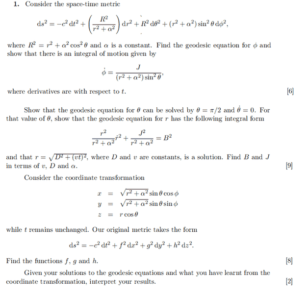

(a) Find ##\dot \phi##.
(b) Find the geodesic equation in ##r##.
(c) Find functions g,f,h.
(d) Comment on the significance of the results.

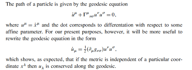

The geodesic equation can be written as
##\dot u_\mu = \frac{1}{2} \left( \partial_\mu g_{v\sigma} \right) u^\sigma u^v ##

Thanks very much for taking time out. I'm stuck on part (b) as they want us to show the geodesic equation for ##r## is ##\frac{r^2}{r^2 + \alpha^2} \dot r^2 + \frac{J^2}{r^2+\alpha^2} = B^2##. I tried to do that in part (b), but the form is so different.
I am not certain what type of geodesic you seek. However, whatever the geodesic type, the quantity
[itex]-c^2 \dot{t}^2 + \displaystyle \frac{R^2}{r^2+\alpha^2} \ \dot{r}^2 + R^2 \dot{\theta}^2 + (r^2+\alpha^2) \sin^2 \theta\ \dot{\varphi}^2[/itex]
is a constant of the motion. Call it C. Its value is zero for light-like geodesics, -1 for time like geodesics, and +1 for space-like geodesics.
You have already shown that
1. [itex]\dot{\varphi} = \displaystyle \frac{J}{(r^2 + \alpha^2) \sin^2 \theta}[/itex]
2. The theta-equation is satisfied by [itex]\dot{\theta}=0, \ \theta = \pi/2[/itex]
Inserting these values in the above constant for the motion gives
[itex]C = -c^2 \dot{t}^2 + \displaystyle \frac{R^2}{r^2+\alpha^2} \ \dot{r}^2 + 0 + (r^2+\alpha^2) \ \left( \displaystyle \frac{J}{(r^2 + \alpha^2) \cdot 1} \right)^2[/itex]
The metric does not contain t, so [itex]\dot{t}[/itex] is a constant of the motion.
Unless I have misunderstood the question, this appears to give the answer that you want.
A bit of advice: the metric ds^2 can be used to construct a Lagrangian function L by replacing all d(variable) objects on the RHS of the metric by that same variable dotted. In particular, your metric gives
[itex]L = -c^2 \dot{t}^2 + \displaystyle \frac{R^2}{r^2+\alpha^2} \ \dot{r}^2 + R^2 \dot{\theta}^2 + (r^2+\alpha^2) \sin^2 \theta\ \dot{\varphi}^2[/itex]
Putting this Lagrangian into the Euler-Lagrange equations delivers the equations for geodesics. Any (undotted) variable that does not feature explicitly in this Lagrangian yields a constant of the motion, since [itex]\partial L/\partial (variable) =0[/itex]. Also, since the proper time does not appear in L - never! - L is itself a constant of the motion. Constants of the motion permit you to find first integrals of the geodesic equations without doing any integration.

The geodesic equation is
[tex]\dot u_\mu = \frac{1}{2} \left( \partial_\mu g_{v\sigma} \right) u^\sigma u^v[/tex]
where the dot represents a derivative to any affine parameter.
Taken from Hobson:
In this question, I let it be ##t## to find ##\dot \phi## in the first part. But isn't the metric always
[tex]c^2 d\tau^2 = -c^2 dt^2 + \left( \frac{R^2}{r^2 + \alpha^2} \right) dr^2 + R^2 d\theta^2 + (r^2 + \alpha^2)sin^2 \theta d\phi^2[/tex]
where ##\tau## is the proper time?
t is not an affine parameter in general.

Ok, after reading through your comments I realized I have been doing this the wrong way completely. Here's my new attempt:
Part(a)
Letting the lagrangian be ##L = -c^2 \dot t^2 + \frac{R^2}{r^2 + \alpha^2} \dot r^2 + R^2 \dot \theta^2 + (r^2 + \alpha^2)sin^2 \theta \dot \phi^2##, where ##\frac{d}{dt} \left( \frac{\partial L}{\partial \dot q_i} \right) = \frac{\partial L}{\partial q_i}## where ##q_i## is a coordinate in the metric. Can I choose the 'dot' to be with respect to ##t##? Choosing ##q_i = \phi##, we have
[tex]\frac{d}{dt} \left[ 2(r^2+\alpha^2) sin^2 \theta \dot \phi \right] = 0[/tex]
[tex]\dot \phi = \frac{J}{(r^2+\alpha^2)sin^2 \theta}[/tex]Part(b)
For ##\theta = \frac{\pi}{2}## and ##\dot \theta = 0##, the lagrangian becomes ##L = -c^2 \dot t^2 + \frac{R^2}{r^2 + \alpha^2} \dot r^2 + \frac{J^2}{(r^2+\alpha^2)}##. Thus shifting the constants to the left gives
[tex]L + c^2 = B^2 = \frac{R^2}{r^2 + \alpha^2} \dot r^2 + \frac{J^2}{(r^2+\alpha^2)}[/tex]
This is the first equation.
For the second equation, I use ##\frac{d}{dt} \left( \frac{\partial L}{\partial \dot r} \right) = \frac{\partial L}{\partial r}##, giving:
[tex]r \ddot r + 2 \dot r^2 - \frac{2 r^2 \dot r^2}{r^2 + \alpha^2} = \frac{ \alpha^2 \dot r^2}{r^2 + \alpha^2} - \frac{J^2}{r^2 + \alpha^2}[/tex]
I can replace the term ##\frac{J^2}{r^2 + \alpha^2}## and solve for ##B^2##.
Part(c)
Do I simply find ##dx^2##, ##dy^2## and ##dz^2## and compare it to the original metric to find ##f,g,h##? Does the condition ##\dot \theta = 0## and ##\theta = \frac{\pi}{2}## still hold?
For example, we have
[tex]dx = \frac{r}{\sqrt{r^2 + \alpha^2}} cos \phi (dr) - \sqrt{r^2+\alpha^2} sin \phi (d\phi)[/tex]
[tex]dy = \frac{r}{\sqrt{r^2 + \alpha^2}} sin \phi (dr) + \sqrt{r^2+\alpha^2} cos \phi (d\phi)[/tex]
[tex]dz = cos \theta (dr) - r sin\theta (d\theta) = 0[/tex]
Substituting them instantly gives back the metric. Does this mean that ##f = g = 1## and ##h## can be anything?

Part (a): not quite, though in this particular calculation, it makes no difference in the end. The total derivative in the Euler-Lagrange equation is with respect to an affine parameter: proper time for time-like geodesics, proper distance if geodesic is space-like, and an arbitrary affine parameter if the geodesic is light like. Similarly, the dot on the dotted coordinate must be differentiation with respect to an affine parameter. In the case of part (a), [itex]\dot{\varphi}[/itex] is with respect to an affine parameter for the geodesic. Same for [itex]d/d\tau[/itex], but when you integrate this particular equation, the answer is the same whatever you take the differentiation variable to be. In general, however, replacing [itex]\tau[/itex] with t is not valid unless you use the change rule for differentiation to get the correct derivative.
(b) In principle correct, but the comment about the derivative and the dot is the same as above. You must use the correct variable, and it is the affine parameter, which t is not, or you will not get the correct answer. In your solution, the over-dot saves you, since the formal calculation looks the same whatever the over-dot represents.
(c) I think that they want you to substitute the squared d(variable) into the original metric.
