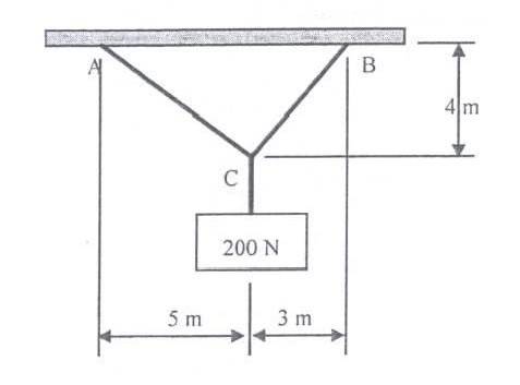

2 cables are tied together at C as shown. Determine the tension in AC and BC.
(ans: 120.1N, 156.3N)
tan-1 4/5 = 38.66
tan-1 4/3 = 53.13
100/tan 38.66 = ACx
ACx = 124.99
AC = sqrt(124.99^2 + 100^2)
AC = 160 (wrong)
If T1 is the tension in AC and T2 that of BC, then x-components of T1 and T2 cancel each other. Hence
T1*cos(38.66) = T2*cos(53.13) ...(1)
Similarly y-components of tensions add up to 200 N.
Solve the two equations and find T1.
