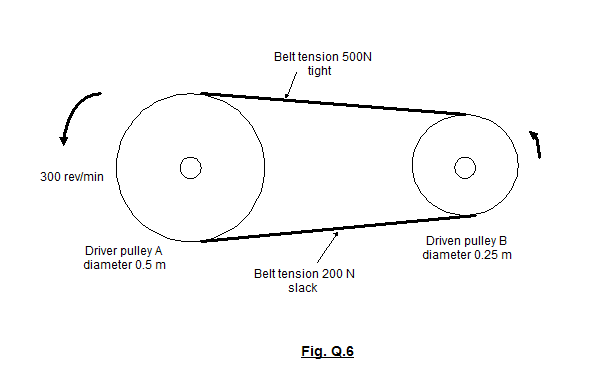

(b) Fig. Q.6 shows a belt drive system where pulley A (diameter 0.5 m) is transmitting power to pulley B (diameter 0.25 m), mounted on a parallel rotating shaft. The tight and slack-side tensions of the belt are 500 N and 200 N respectively, and pulley A rotates at 300 rev/min.
Determine
(i) The linear speed of the belt (in m/s))
(ii) The rotational speed of pulley B (in rev/min)
(iii) The torque on pulley B.
(iv) The power transmitted to pulley B.

i did my best, can some one tell me if I am on the right track or I am totally off

You have the right idea. However, the radius of pulley A is not 0.5m.

Not quite. Hint: both pulleys have the same linear speed.

Yes, that's right.

You have the right idea, but will need to use the correct value of Wb to get the correct answer here.

Okay. You know that the linear speed v is
v = r ω​
And since the linear speed (= the belt speed) is the same for both pulleys,
rA ωA = vA = vB = rB ωB
Also, B will have a different rotational speed (not 300 rpm) than A.

(ii) asks for ωB. You know what rA, ωA, and rB are. Solve the equation for ωB.

So
Va=RaxWb = Vb=RbxWb
Since Va=7.85m/s
Vb=RbxWb
7.85=0.125xWb
0.125Wb=7.85
Wb=7.85/0.125=62.8rev/min
is that correct?
Almost, except for the units. It's 62.8 rad/sec.
