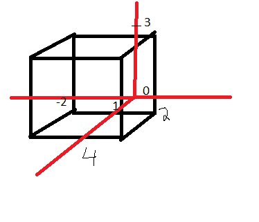

Suppose the one-dimensional field A = Kx * ax exists in a region. Illustrate the validity of the Gaussian theorem by evaluating its volume and surface integrals inside and on the rectangular parallelepiped bounded by the surfaces: x=1,x=4,y=2,y=-2,z=0 and z=3, for a given A.
(Right) [itex]\int_0^3[/itex][itex]\int_1^4x[/itex]dxdz ay + (left) [itex]\int_0^3[/itex][itex]\int_1^4x[/itex]dxdz -(ay) + (top) [itex]\int_{-2}^2[/itex][itex]\int_1^4x[/itex]dxdy az + (bottom) [itex]\int_{-2}^2[/itex][itex]\int_1^4x[/itex]dxdy -(az) + (front) [itex]\int_0^3[/itex][itex]\int_{-2}^2[/itex]dydz (ax) + (back) [itex]\int_0^3[/itex][itex]\int_{-2}^2[/itex]dydz -(ax)
Direction on the left is applied to the integral on its right.

When I add these up, I get zero... however, when I use the divergence theorem I get 36.
This answer is suppose to equal the answer I get via the divergence theorem formula. I'm confused :(
There are only 2 sides that "see" the field A head-on. Mathematically, there are only two sides for which ∫A*ds ≠ 0 where ds is a vector element of area on any side. Which sides are those?
Now integrate A over those two sides, remembering that the dot-product A*ds will be positive for one side and negative for the other. In other words, the normal to any closed surface always points out of the surface.
