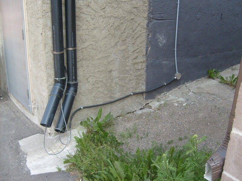

What are these DWV pipes with cables inside for?
  • Thread starter Keith_McClary
    Cables Pipes
17 replies · 2K views · last reply
Keith_McClary
752
1,507

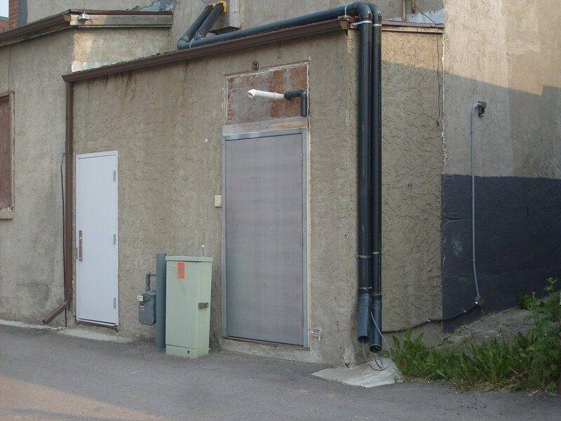

The main floor is an office. The second floor might be an apartment.
Exterior of a stucco building beside an alley: two doors, a green electrical meter cabinet and meter at ground level, and black vertical drainage pipes running down the wall.
Two black plastic pipes run down a stucco wall beside a grey metal door and end in angled cut-offs above a concrete pad, with grey cables routed alongside and a black conduit-like cable running along the wall to a fitting.
What is a DWV pipe? And is that a permanent practical joke (PPJ) pipe over the door?

The white one could be an exhaust for a built-in vacuum system.
Baluncore said:
What country, what city?
Crowsnest Pass, Alberta, Canada.
At first I thought protection of cables from ice or animals, but that did not add up.
My guess is that the conduit above the door was for a light when there was a cover over the doorway. Many older buildings in Crowsnest have a lamp high on the wall. That probably relates to the long winter nights in the period before the installation of the street lighting.
The drain pipes may freeze up in winter. The wires are probably electrical resistance wires that will thaw sufficient of the ice to allow the discharge to flow again.
Why there are two pipes I do not know, maybe two quite separate systems discharge meltwater.

The roof drains are usually aluminum like the brown downpipe on the left of the white door, and I have not heard of them freezing up or needing heating (If it is warm enough to melt the snow on roofs, then the downpipe is also warm.). The black pipes come from inside the building - I can't think what they could (legally) be draining onto the roadway. There are basement sump pumps that drain through (usually smaller) DWV pipe, but not from the second floor.

In any case, the black pipes come from inside the structure, very unusual for downpipes.
And the heating wires, if that's what they are, look unprotected at ground level. What voltage are these wires?

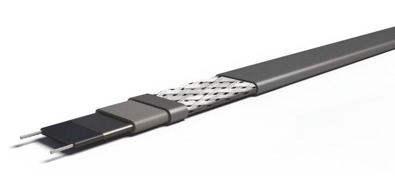

If I were to guess it looks like an antifreezing warming system, similar to the one I have here.
Close-up of a flat self-regulating heating cable with two stripped copper wire ends exposed at the left, a dark jacket, and a braided metal shield section in the middle.
The cable is quite sophisticated - inside there are two copper wires connected with some kind of a semiconductor. That means two things: first, no matter what their length is, they heat with a constant power per unit length (I don't remember details, I believe mine are something in the 20W per meter range). Second, they don't warm up above some temperature (the resistance grows as they heat up). They are connected on one side only, directly to the mains.
Not really. It may be unusual that they don't stay in the building (and get piped into a storm drain system), but whether they have to start in the building depends on where the roof drains are. You may be able to verify that configuration with an aerial/satellite photo.
But if they aren't roof drains, then the potential for icicles may be worse, not better, depending on what they are.
They are insulated, line voltage (varies).
My guess would be that they are telephone cables being routed in what happened to be there.
I'm going with the heating cable theory. What I thought was a second storey seems to be an attic under a roof sloping to the front of the building, so the water from the roof is drained from the front back to the alley through the cold attic.
If we had the full address, we could use Google Earth street view to see the building.
Baluncore said:
street view
It is the left third of the former pharmacy.
From the rear you can see how the roof slopes down towards the front (most of these buildings slope towards the back). The openings are louvered vents, so the attic space is cold in winter. The pipes are different, possibly related to renovation from pharmacy to office.
