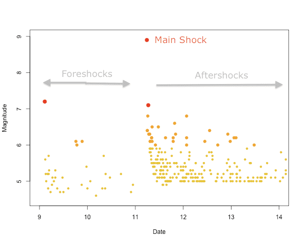

Ah hah, that's the $6 million question :wink: We never know if it's a foreshock to a much bigger event or just a stand-alone event
There's examples of both in the seismic records
eg ... the Japan 2011 M9 event ... it had 3 significant foreshocks
Mar 9, M7.2 followed by 3 x M6.x events then Mar 11 the M9 shock
One could say ( and rightfully so) that the 3 x events were just aftershocks of the M7 main shock.
But what makes them all foreshocks of the M9 event is their close association to the M9 both in location and in time
The big problem is, we never know that they were foreshocks, or not, till after the fact
As they say, "Hindsight has 20/20 vision" :wink:Dave
