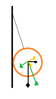

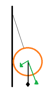

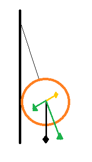

Let's use drawings.
This is what weight looks like:
The green arrows are the components of the weight. The long one creates tension in the string (less than the weight) and the short one creates a moment that wants to rotate the ball.
If there is no angular acceleration, then there must be an equal and opposite moment acting. To help you see it, I will assume the force needed to create that opposite moment is acting at the cg as well (this way the forces are equal and opposite too):
But we know that the only force we can put is an horizontal force, and ours is angled. So our angled force must be a component of our horizontal force:
Now our horizontal force have 2 components: the one to counteract the moment and another one which also pulls on the string. That other component must be added to the one from the weight (long green arrow). The addition of these two tension forces is actually greater than the weight itself.
There are other situations where an counteracting force exceeds the input force; think of levers for example.

jack action said:
Let's use drawings.
Thank-you very much for this visual. It helps me see how the theory works.
