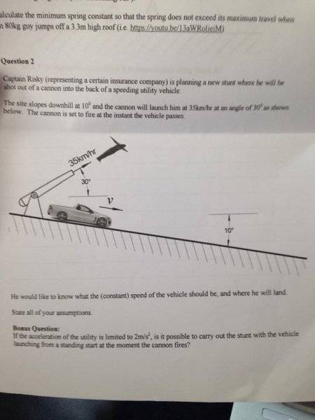

Planning a new stunt where he will be shout out of a cannon into the back of a speeding utility vehicle
the sit slopes downhill at 10 degrees and the cannon will launch him at 35Km/Hr at and angle of 30 degrees as shown in the attached picture
I cannot seem to find a solution I can't think of a method to go about using.
