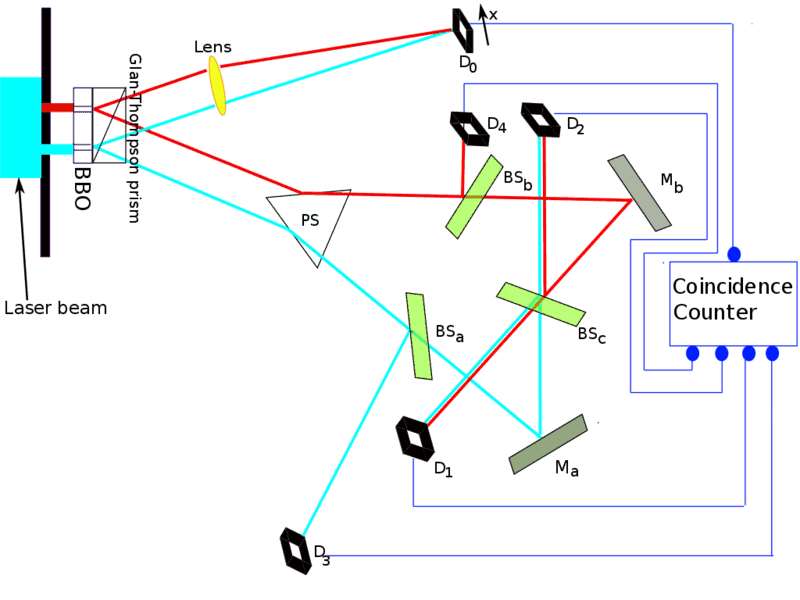

I think it might help if the type of experiment fluidfcs seemed to refer to was discussed. There's a big choice of experiments including the very famous one one carried out by Kim et al. Patrick Edwin Moran prepared a nice schematic of the apparatus used and I think this is a good representation of the apparatus actually used. I'm guessing Kim et al approve of it. With reference to this schematic we could ask questions such as the following:
1. What is the purpose of the prisms the lens and the mirrors?
2. What do the red and green lines represent?
  • #70
Do you have a reference, where this schematic drawing is explained in more detail? Is it referring to the quantum-eraser experiment (at least it looks like a colored version of Fig. 2):
https://arxiv.org/abs/quant-ph/9903047v1
https://doi.org/10.1103/PhysRevLett.84.1ad 1. They have the usual purposes as optical elements and are described as in classical electrodynamics with an index of refraction.
Light rays, i.e., directions of wave vectors or in this case, because single photons (in entangled biphoton states) are prepared, of photon momenta.
Good point.

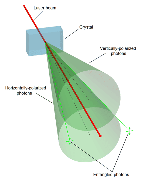

The setup was presented in a diagram in OP's post #3. It is just a generic diagram of a Bell test using polarization, PDC source. Because he was asking basic questions about "paths", I answered using "paths". No reason to explain to him that some physicists don't believe in the Photon (see Lamp's Anti-photon), or to others that Photons are "excitations of the quantized electromagnetic field" (QFT), or that photons don't move precisely on classical paths. All of which are technically correct but not important to the OP - whose level of knowledge likely would not appreciate the nuance of those points.
As to your Kim diagram: the red and green lines represent the paths of the A and B photons... :smile:
The schematic I posted is basically the same as the schematic in Kim etal's paper ( Arxiv version) but is slightly more detailed in that idler photons from both semi silvered mirrors a can be detected.
  • #80
DrChinese said:
Good point.
Agreed.
