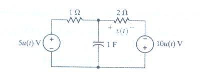

Laplace Error in a Circuit !
Hello
as you see this circuit
i want to find the v(t) across the 2ohm resistor.(VC(0-)=0)
i assume A node above the capacitor , so we have (in Laplace)
so i have
so A=0 ! or S=-3/2 ! what can we understand about A=0 or S=-3/2 ? what is their inverse Laplace in time zone?
now how can find the v(t) across the 2ohm resistor? Thanks
Hello Again
i have a new question about above circuit. now how can find the voltage across the capacitor?
What's wrong with A=0? That just means there's no voltage drop across the capacitor, so finding the voltage across the resistor should be pretty straight forward. Also, you shouldn't call s=-3/2 a solution, because your node equations should hold for all values of s. The only way your node equation holds for all values of s is when A=0. Hence, the voltage across the capacitor (A) is zero.
Admittedly this is a bit of an odd circuit. Here's two things you can do to try to understand.
1. Replace the 5/s source with an arbitrary source V1(s) and replace the 10/s source with an arbitrary source V2(s). Solve for A(s) in terms of V1(s) and V2(s). You should see that when V2 = 2*V1 (as is the case here), A(s) goes to zero, but if not A(s) will have an exponential response like you would normally expect. Essentially, in this case the sources are perfectly balanced so that they don't charge up the capacitor. If you had a 5/s source and a 15/s source, the capacitor would charge up to some value and A(s) wouldn't be zero.
2. Look at the steady state response. What would you expect the voltage on the capacitor to be as t goes to ∞? The capacitor is starting at zero volts, and then charging up to this value. Can you see why the voltage on the capacitor would stay constant at zero?
