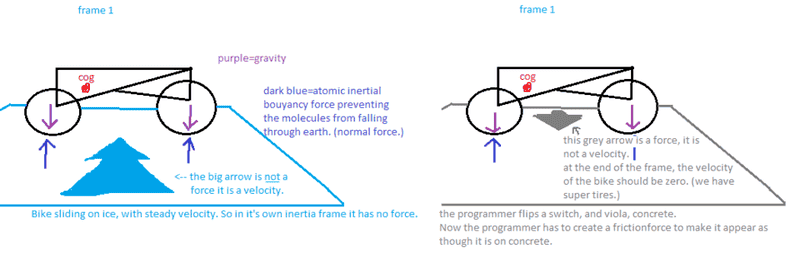

Also, I've been doing some thinking and I believe my original methology used the wrong approach and had an error.
My original methodology (that I described here) was to have a function that was based around grip...Each tire had 25% grip and so it caused the car to turn well at low speeds of about 10 miles an hour. But the problem was, I plugged the 0.8 (kinetic friction) directly into the grip...so instead of 25% grip it would be 25%*0.8. This is a mistake, because the actual kinetic friction force should be 0.8*weight and not simply setting the counterforce to -totalcaraccelerationforce*0.8.
I have a headache right now and I need to go eat, haven't eaten a real meal in hours. But I shall run more tests and return to you tomorrow. I forsee running into more problems, even though I found one of my mistakes I think I will run into more issues. I may have climbed the hill, but I'm not sure I climbed the mountain.
And yes, I meant to put carweight instead of carmass. Also, this creep angle thing brings me more questions than answers...Slip angle, for me means the contact patch is actually twisted relative to the tire, so to determine from a game standpoint what the slip angle is, is harder than simply getting the angle of the visual tire. Also, I am not sure what effect the slip angle has on the kinetic friction coefficient...According to Pajeck formula the slip angle seems to affect the amount of force the car can handle before it slips. But physicists say the kinetic coefficient is always static, so its confusing. Maybe its because, the slip angle inherently means there is less "rolling give" in the tire, making the tire less availiable to de-stress, when you turn the tire at an angle and such that's more stress on the axle, since the tire cannot roll with it any longer.

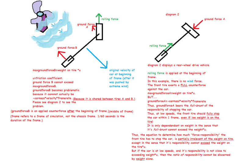

I corrected the mistakes of my past equations, but still have problems. The car does behave more similar to a car now, but, it is way too slippy. It suffers from a problem in some old Gamecube games, it is when you are driving the car and you begin to spin out, and when you correct the spin out, the angular rotation speed (the car's omega) goes to zero, so you think you're safe to drive, but as soon as you let go of the tires, it begins to spin out again, like you never reset the angular rotation speed to zero.

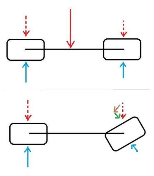

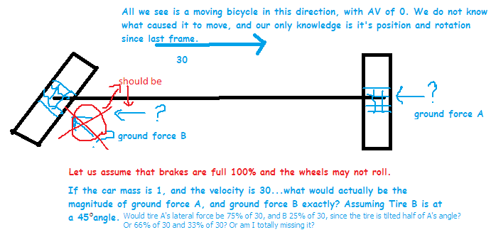

So I went back to the basics, trying to understand the theory behind a tire that grips 100%. Here is what I'm not understanding...lets say you have a perfect tire, with a uS and uK of 1000, that grips 100%. And you want to put this in your engine, just to test that your simulation can grip 100% and behaves properly, (before you move on to adding slip and weight and other things). But here's the problem...

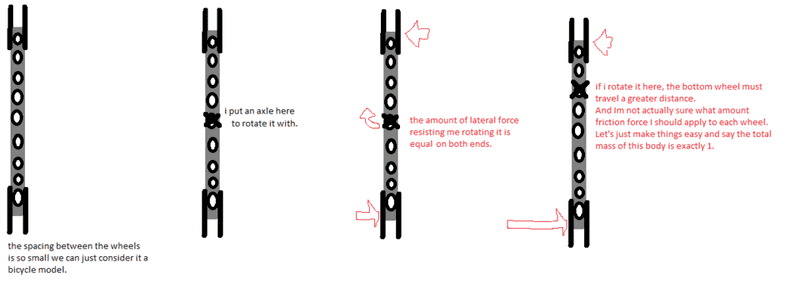

Lets say you have a max steering angle of 90 degrees (just to test the engine and see that the tires can make the car stop 100%.) And so, this is very easy to plot the equation, you just set the force to apply to the left front tire to be -carvel*phy_mass/2 and the right tire to also have the same force applied to it. This will stop the car dead in it's tracks, which is what you want before you move on to testing the advanced stuff and adding slip behavior.
Now...stage 2...The steering angle is 45 degrees...so now you use a dotproduct to figure out the lateral cancellation distance...So now its still simple...you just set the left front tire to apply a force of -dotproduct*phy_mass/2 and the same for the right front tire.

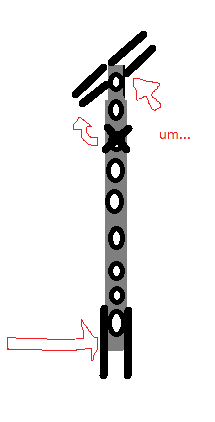

But now...adding the back tires...its not so simple...
Because now the back tires have also to cancel out the lateral velocity of the car...so now your equation for each tire looks like -dotproduct*phy_mass/4...But this is wrong because...now the front tires will not stop the car dead in it's tracks any longer...
To make matters even worse...imagine your car is skidding at a 40 degree angle...how would you compute the amount of counterforce to apply to each tire so that the car stops dead in it's tracks? I have no idea.

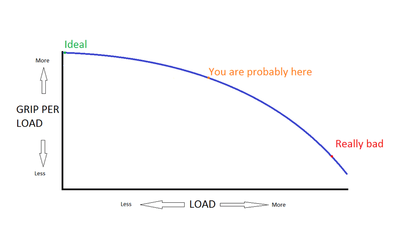

quickquestion said:
In all physics lessons, it is implied μK is a constant. That once a tire's lateral and longitudal force exceeds the weight on the tire, the friction coefficient changes from Static (mU) to kinetic. (μK). But it is implied that μK is always constant, does not change based on speed or slip angle of the tire.

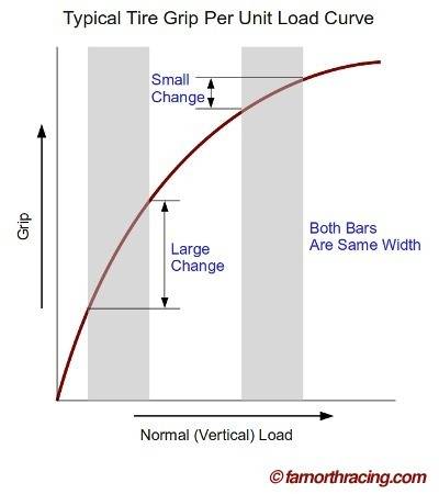

With a rolling rubber tire, the friction coefficient is not constant. In the thesis you refer to in post #5, it says on p. 17:
The lateral force depends on the load of the tire. In order to find lateral forces at different loads, we could assume that the lateral force is linear with load and create a normalized lateral force diagram by dividing the lateral force by 5KN.
This is wrong, because the lateral force is NOT linear with load. This is why load transfer is bad for vehicle: a car with the weight equally divided among identical tires (25%-25%-25%-25%) will always outperformed any other weight distribution.
The coefficient of friction decreases as load increases.
Once you reach slipping, i.e. kinetic friction coefficient, not only the friction coefficient drops noticeably, but we then go back to a more traditional definition of friction, i.e. fixed rubber sliding on a surface instead of rolling. So the kinetic coef. is not as affected by load as the static coef. is.
As for slip angle, I prefer to see it as a consequence of the lateral force more that the cause. A lateral force will cause a slip angle, for which the magnitude will depend on the tire construction. The slip angle will modifying the actual rolling direction of the tire (i.e. steering angle) and so will create an apparent lateral velocity to the tire rolling axis.
The normal weight is the important factor that affects lateral grip capabilities.
Also the friction coefficient of a tire is not necessarily 1.0, it can be higher or lower.
References:
Tire load sensitivity on Wikipedia;
[PLAIN said:
http://farnorthracing.com/autocross_secrets4.html][/PLAIN]
The key to this process though is that while more force pressing the tire into the road provides more grip, the amount of grip generated per added unit of normal force declines on a curve. For example, 100 lbs of normal force (which I'll call load from now on) might provide 100 lbs of grip, 200 lbs of load might provide 150 lbs of grip, and 300 lbs of load might provide 175 lbs of grip. Always more grip with more load, but also always less grip per unit load as grip increases.
This property means that for any pair of tires, they will provide maximum grip when equally loaded.
http://www.rhoadescamaro.com/build/?page_id=669 said:
The following graph explains the most important thing you need to know about all tires on all production cars. Since it is so important a concept, I'll state it a few different ways, hopefully one of them clicks and makes sense with the reader. Nothing in any of the chapters to follow, will make any sense until you get this, a slightly exaggerated tire load response curve:
Most succinctly, as we increase the load on a tire, the total grip the tire provides goes up, but the amount of grip we get per unit of load (this is also known as coefficient of friction, or "mu"), goes down. The more we increase load, the greater the rate of grip drop-off; it just gets worse and worse. On the other side, as we decrease load, we lose grip, but we don't gain as much mu from the load decrease, as we lose from an equal load increase.

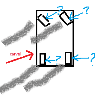

The magnitude of the velocity has nothing to do with it, except in regard to centripetal force.
If the car is already skidding at this point then the direction of velocity matters, but not the magnitude.

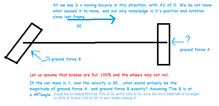

Is that 90 degrees to the chassis or 90 degrees to the velocity?
Your diagram appears to show a vehicle already skidding, with front wheels at right angles to the direction of skid.
I assume there is no braking. If so, you are right to draw the force arrows as you have, perpendicular to each tire.
Each friction force will equal normal force * μk, but the normal force might be different for each tire. In the diagram, the right hand tires will have greater normal force, particularly front right, because of the tendency of the car to roll on its suspension.
Oh, dot product is the same as lateral cancellation distance, it just tells you the lateral cancellation vector (basically it is the vector from this article right here: http://www.iforce2d.net/b2dtut/top-down-car Note: this article produces unrealistic physics.)
Also, maxsteeringangle refers to the tire direction relative to the front axis of the chassis. In normal cars its about 30-40 degrees, but in my beta-testing mode I put it to 90 degrees to test whether or not the tires put the car to a complete stop (they don't, thus my simulation sucks.)
This is actually a relief for me...I was having trouble accepting the idea that the uK of a tire remains constant. I got this idea after watching various youtube videos teaching physics, such as this video: www.youtube.com/watch?v=bkZ8bGYYAPQ
However, I want to state this, that the statement "lateral force changes on the load of the tire" in no-way implies that mU is dynamic. By the statement, it could been intended to mean that lateral force could change purely based on weight (N) alone.
Would you happen to know the gradient of the coefficient as it changes in relation to the weight, speed, acceleration, centrifugal, and other factors it has?

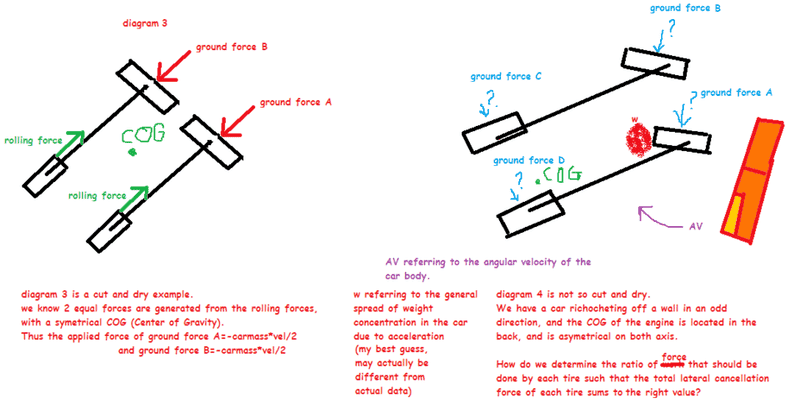

Hmm, but if I do it that way, there is a problem. Tire order.
If I am going 10 miles an hour sideways (when the grip is disabled for testing purposes), and I want to enable the grip...I switch the button to enable the grip physics and then I apply it to the front tire...The front tire makes the car come to a complete stop, and none of the other tires do anything. Or what happens is, the front left tire causes a torque, and then the other tires are now using up their frictionforce quota trying to stop a torque that shouldn't exist in the first place.

The problem here lay in this statement: - "determine the acceleration being demanded of it; this includes any attempt at braking, steering, centripetal acceleration and pressing the accelerator; the acceleration so determined has a magnitude and a direction; note that different accelerations may be desired for different tires"
Consider the case of 2 90 degree steering angle front tires and the car is going forwards (this is not a real life car, most cars do not have tires pointed 90 degrees...its just a test car for testing purposes.)
Left has an acceleration of say, 10 mph. So if it cancels that, that leaves no work for the right tire to do...causing a torque. But let's say, we split the work for both tires...Works fine in our situation...but let's say we have other situations...such as all four tires with non-90 degree angles and accelerations...How do we know "What" or "how" to split the acceleration as between each tire?
Just concentrate on the normal load for now. Actual data is almost impossible to get as tire manufacturers rarely share them.
quickquestion said:
Some lectures tell me it can be as high as 1.7. There is a website out there that lists the different coefficients for truck tires and bicycle tires and such.
You can look at this web page; look also at the sources at the bottom of the page.
So, you are saying the uK changes based on the normal load? Because the equation they teach in high school is uN...but are you saying, for in-terms of realistic tire behavoir, the equation should be more like u/(1+N/2)*N?
Ha, that is exactly the website I was talking about.
From the Wikipedia link I gave you earlier:
In practice, the maximum horizontal force Fy that can be generated is proportional, roughly, to the vertical load Fz raised to the power of somewhere between 0.7 and 0.9, typically.
So, instead of the classical ##F=\mu N##, you could use ##F=\mu N^{0.8}##. Let's say you know - using the classical method - that for a certain value of ##N_0##, the coefficient of friction is ##\mu_0 \left(=\frac{F_0}{N_0}\right)##, then you can estimate that ##\mu = \mu_0 N_0^{0.2}##, such that ##F=\left(\mu_0 N_0^{0.2}\right) N^{0.8}##.
Ohhh...I thought that link was an advertisement that appeared at the bottom of certain posts.
Yeah...that 0.8 exponent thing seems pretty nifty, I think it may come in handy. Thanks.

Say they are 4 tires, and the car is going forwards, and then I suddenly tilt the front tires to 90 degrees...Apparently...the engine should "know" to consider the velocity of the front tire as Half of the totalcar velocity, and the left tires input velocity to be handled as Half of the total car velocity. And that the back tires should be ignored...this is easy. But when the car is going at angles and the front tires are angled different from the rear...how does it know "which proportion" of input velocity is to be decided for each tire...I can't just say "Use half of the car velocity for the front 2 tires" or "Divide the total velocity by 4 for each tire". This is what I'm having trouble understanding.
quickquestion said:
The car, as a uniform object, has a velocity direction at a 40 degree angle...But I don't know in what proportions the velocity should be handled for each tire...

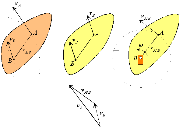

The velocity for each wheel can be found knowing the vehicle velocity ##v## and its yaw angular velocity ##\Omega## (##v+\Omega d##; ##d## being the distance from the cg to the wheel).
I think the problem you referring to is for a force. When there is a purely lateral or longitudinal force act on a vehicle, the wheels are aligned, so the reaction forces can easily be split between both sides, just like a simple beam with 2 supports. When the force is at another angle, it can be more completed because you are now looking at a beam with 4 supports. So you have to separate the force into lateral and longitudinal components and analyze them separately.
quickquestion said:
Say they are 4 tires, and the car is going forwards, and then I suddenly tilt the front tires to 90 degrees...Apparently...the engine should "know" to consider the velocity of the front tire as Half of the totalcar velocity.
What do you mean by "tilt the front tires to 90 degrees"? The steering cannot steer the wheels that far, but if it instantaneously did, they would stop turning and slide.
Well I meant for a simulated car that has custom steering that you can set to 90 degrees (instead of the usual 30 degrees). At low speeds, if the simulation is behaving correctly, on tires with a high uS value and are at 90 degrees, the car should stop all forward movement.
Yes this is exactly it. The physics papers tell me that the friction force (not the rolling force, but the sideways cornering force) should be Fmax=uN. But they never tell me what ratios to apply it to each tire. The papers would work for say...a unicycle, but the ratios to apply to each tire is a mystery.
If there is no ackerman steering and only the front tires are turned, but the backwheels are going the same direction as the car, the ratio is easy - 0 lateral force applied to the back wheels, and 1/2 the Fmax applied to each front wheel. But when the car is sliding at non-uniform angles and the car tires are not the same angle as each other...the ratio is a mystery.
To find the ratio it is not simply by using a normalized weight distrubtion. For instance, if the weight is balance 25% weight on each tire, and you simply say Ff=uN*weightpercentage, it won't help, because imagine that the backwheels are going the same direction as the car, but the front wheels are angled...If the cars weight was still 25/25/25/25 the front tires would only apply 25/25 and not stop the car properly. So the problem is much more complex, and I'm not sure what the solution is. How would I go about analyzing it as a beam with four supports?
The magnitude of the (static) friction force doesn't depend on the weight or the friction coefficient, only the maximum static friction force does. So the value can be anything between zero and the maximum (##\mu_s N##). So you can analyze the vehicle as a static structure which is solidly pinned down. If any of the friction forces goes beyond the maximum value, that is when you have to change the conditions and set those forces to their kinetic friction values and redo your force analysis. You also know at this point that these tires can slide and the tire is no more "pinned down" and will move sideways if the other tires cannot hold the car either.
Yes, I knew that already.
Yes I know, but how do I find out how to "ration" out the force.
Consider this. If a car is going 3 mph sideways, here's the problem...We only have a net max friction force of say, 3 units. So we must choose which tires to ration out the force to. We can only ration out so much force, if we do full force for each tire, the tire will actually have too much friction force and the car will go backwards and possibly violate the conservation of energy (possibly having more output than input - flubber tires.)
So... if the front tires are the only ones doing the lateral cancelling, then we apply /2 the front tires, none to the back. But if its a mix of it, then we may need to give 25% importance the the front tire only. But I don't know how to get the computer to automatically calculate these ratios. If I give 25% to all tires at all times, it is incorrect. But if I give 50% to the front left and 50% to the front right it is also incorrect. I have a net force (which I call the car force) that I have to divie up for each tire.
For example, if the car is going 3mph, then the friction force should full cancel out any lateral motion. If the front tires are doing all the cancelling, then its simple, we simply give 50% importance to each front tire. But if the back tires are doing some cancelling on their own...we might say give 25% importance to each front and back tire. But I don't know how to determine these dynamic ratios.
It is a statics problem: ##\sum F_x = ma_x##, ##\sum F_y = ma_y##, ##\sum M = I\alpha##. Whatever net force is acting on your vehicle (please, stop talking about speed), you can decompose this force into 2 components: lateral and longitudinal. You analyze each force independently. This way, you can combine the wheels from the same axle (with the lateral force) or the same side (with the longitudinal force) and split the reaction 50/50 between the 2 wheels. Then you add the reaction forces for both analysis on each wheel.
If your wheels are angled with respect to the vehicle, you have to consider properly the reaction which is both lateral and longitudinal with respect to the wheel. So a pure lateral force on the vehicle will be partly lateral on the steered wheels and also partly rolling (considering rolling resistance, braking, acceleration).

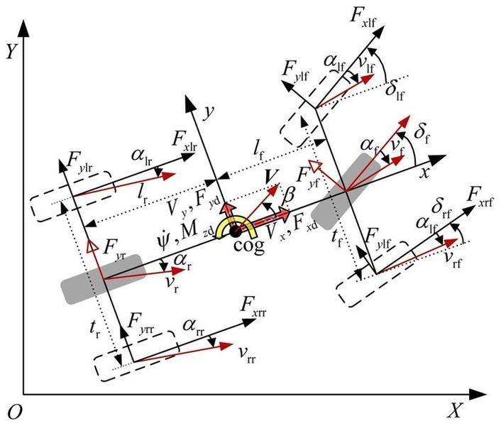

Search for the bicycle model, where the left and right wheels of each axle are combined to a single one (the grey wheels in following figure):
Then what did you mean by the below part?
quickquestion said:
...the engine should "know" to consider the velocity of the front tire as Half of the totalcar velocity, ...
Okay, what I was saying was, if a car has a low force applied to it, that means you don't apply the full Fmax in the opposite direction to stop it's movement.
Because if you do, instead of 100% cornerning grip, you may have 150% or 200% (as if you are hitting and bouncing off an invisible wall - the car will actually go backwards like it hit something.) And if you have 201% cornering grip, you actually have flubber physics where the car bounces off with more energy than had in the first place.
So basically, if a car has low force on it, you cannot apply the full Fmax to each tire, rather you can only apply the exact amount of force it takes to make the car stop moving (Force=mass*acceleration, so the amount of force you have to work with is carmass*car_velocity/60) Because you want to apply a force (an impulse at 1 frame) which makes the car stop moving. If the framerate is 60 fps, then it's /60. If the framerate is 30 its /30. If the car velocity is per frame and not per second then the equation changes. Anyway, the main point of it is, you have a set amount of force needed to stop the car. And you have to figure out how much of it to apply to each tire in order to get the right behavior. So lectures (like from iforce2d) don't give the right behavoir because they don't accurately divie up the force for each tire. It is not as simple as saying "Oh apply a counter force to each tire to stop all lateral movement." Because what most of these lectures don't tell is the ratio of the carforce (counter movement force) that must be divied unto each tire.
Search for the bicycle model, where the left and right wheels of each axle are combined to a single one (the grey wheels in following figure):Search for the bicycle model, where the left and right wheels of each axle are combined to a single one (the grey wheels in following figure):
Using a bicycle model seems to be the real deal, though that picture is a lot for me to digest at the moment (Just last night I forgot the lock combo I have been using everyday.) But from what I can sense, Jack and I seem to getting towards the same page. I am actually going to start working on modelling bicycle physics and then work on the problems from there. My guess is, you get the net lateral velocity on the chassis, and then get the longitudinal velocity of the chassis, and go from there? Still not understanding fully, but hopefully it will "click" soon.
