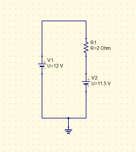

I think your hangup is that you are wondering how we represent useful work in a circuit diagram.
Let's look at a simplified circuit for a series wound DC motor
The source on the right represents the back EMF of the motor. The current of this circuit is easy enough to calculate (12-11.5)/2= 250mA. Notice that the current flows out of the cathode V1 but into the cathode V2. Power is still (P=VI). So, V1 is emitting 3W, and V2 is absorbing 2.875W which is being converted to mechanical work.
This is just one way that we can represent a "sink" for electrical energy. In this case the back EMF voltage source is a real thing. It comes from the physics of a motor.
