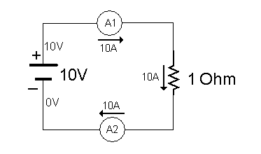

Imagine a simple circuit, an EMF connected to a resistor which connects back to the EMF.
This is how I'm thinking about it
I know there is a current which means that there is charge moving around the loop which means that there must be some field because otherwise the charges wouldve never started moving. So let's look at the wire right after the EMF I'm assuming that the EMF produces some kind of electric field, perhaps by forcing some electrons into the wire, this causes the electrons that were originally at the beginning of the wire to move away from the EMF because of the new charges introduced. I'm imagining that this pattern continues down the wire until it reaches the resistor.
Now what?
I know that however many new charges were introduced into the wire by the EMF must make it back out at the end of the circuit (by the other side of the EMF) in the same amount of time (i.e. the current is the same around the loop) but what is happening at the resistor? Why is there a ΔV? is the resistor causing some sort of field? If it doesn't then why is there a ΔV? If it does then why haven't the charges slowed down in response to this field?Thanks

The amplitude of the current flowing around the loop is determined by the value of the resistor ... I = V/R
There is a drop in voltage across the resistor because there is an energy loss in the resistor
electrical energy is converted to heat and radiated away.
The voltage dropped across the resistor is ... V = I x R
for a loop with a single resistor, the voltage drop across that resistor will equal the supply voltage
for a loop of multiple resistors, the voltage drop will equal the sum of the drops across all the resistors which will equal the supply voltageDave

2) I still don't understand what a resistor is, I know that there is a voltage drop but why?
I answered that
Again, in a slightly different way. A resistor is made of a material that doesn't have so many electrons that are free to move as the copper wire does
that means electrons coming in find it more difficult to move through it. It takes more energy ( EMF) to push the same amount of electrons through.
Tho we all hate water analogies ... imagine a pipe with water flowing through it and you squeeze the pipe somewhere along the length. this impedes the
water flow ( a resistance) ... The pressure also drops as a result
4) I know that the voltage drop is proportional to the current, but is the current the same along the whole circuit?
in a series resistance circuit, yes it is. The current will be measured the same on either side of the resistor
