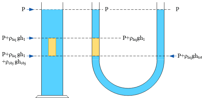

Hello.
Suppose you have an incompressible fluid in a column of infinite height and area and that is in a vacuum. The formula for the net pressure at any point is hpg, where p is the density and h the height.
The formula comes from considering that at h = 0, the net pressure is zero, but that at h = h the pressure there must not only balance the exerted by the random collisions of the molecules, but also that of the weight of all the water above. The pressure from random collisions is balanced because throughout the fluids the molecules move in the same way, but what force balances the pressure from gravity?
I would think it to be a reaction force to gravity, like the normal force when you place an object on a table. In the same sense, the weight of the fluid above is balanced by the normal force of the fluid below, and thus there is a pressure difference due to the normal force exerted by the fluid, but I'm not sure if this is correct. If it is not, then from where does the difference in pressures arise from? I know the force is there because the fluid is stationary, but what causes this force?
Assuming the above is correct, then I have problems seeing the buoyant force.
In most derivations that I have seen, the buoyant force arises due to the difference in pressure in the fluid below and above the object submerged. If the object has volume V, then the buoyant force is pVg, where p is the density of the fluid.
But these derivations seem to neglect the reaction force to the weight of the object. The fluid below the submerged object should feel a force due to the pressure of the fluid above it, and the weight of the object submerged. But in that case, it would exert a force by Newton's third law which would be equal to the weight of the object plus the weight of the fluid above it. This is akin to how I suppose the fluid exerts a reaction force to the weight of the fluid above to balance it. In the derivations, the reaction force to the fluid does not change despite the change in weight on the fluid below. So I must be missing something, but what?

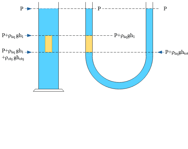

Perhaps this helps:
On the right (the fluid can't get past the object) you get equilibrium with the same level at the top only if ## \rho_{\rm liq} = \rho_{\rm obj} ##.
When ## \rho_{\rm liq} < \rho_{\rm obj} ## you need a higher level in the right leg and
When ## \rho_{\rm liq} > \rho_{\rm obj} ## you need a higher level in the left leg of the U-tube.
On the left the fluid can get past the object and the equilibrium condition
$$P + \rho_{\rm\ liq} g h_{\rm tot} = P + \rho_{\rm liq} g h_1 + \rho_{\rm liq} g h_{\rm obj} $$again requires ## \rho_{\rm liq} = \rho_{\rm obj} ##. If this is not the case, there is no equilibrium and acceleration occurs if there is no external force keeping the object in place.

So then the pressure does not change because the fluid flows?
Supposing you place an object, under its weight, the fluid will flow, and in the liquid column on the left, it would flow upwards because it is incompressible. Then its weight is still on the liquid below it, and the pressure difference will p∆hg, where p is the density of the fluid, and ∆h the height of the submerged object. Then this is what would cause the buoyancy force.
So thank you for answering my question, and thank you for bearing with me. However I just have three more questions in regards to this.
If the object had density equal to the fluid, and it was suspended somewhere in it, let's say in the middle of the column, and at the bottom of the column, I made a tiny hole so that the liquid could flow out. Then liquid below the object would start flowing, so it will exert less pressure, so the object would sink as well? If it was lighter it would sink as well?
Now, if the fluid was actually compressible, would the same thing hold? If I understood well, the buoyancy came from the liquid flowing to adjust for the pressure difference. But if the fluid was compressible, then it wouldn't flow, would it? It would be compressed. And the density of the fluid would change till the pressure of the fluid exactly matched that due to the weight of the object. Is that correct?
And finally, what would happen if the liquid column had the same area as the object, like in the U-tube picture? And the liquid was incompressible. When I place the object the fluid can't flow past it. Would the container explode because of all the pressure? And if the liquid was not incompressible, would it compress under that pressure?
Thanks for taking time to answer my question. I appreciate it.
