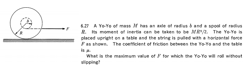

Hi guys. I'm having a bit of trouble visualizing what will happen so if you could first indulge me with the mechanics. Imagine there was no friction to begin with; since the force is acting on the rope wound around the circular axle, will the yo - yo only slide to the right or will it slide to the right + roll backwards due to the pulling of the rope that is wound around the axle? It seems like it should be the second if I try to imagine it (don't have a yo - yo with me unfortunately :[). Now, regardless of that, the center of mass velocity will be directed to the right I think; was only assuming this based on physical grounds that the yo - yo will slide to the right but if the pulling of the rope around the axle causes it to roll backwards then idk if it will slide to the right or not anymore so if someone could clarify this that would be great. Going with that assumption, the friction force would be directed to the left. The equations of motion are [itex]ma = F - f = F - \mu mg[/itex] and, this is another point I would like someone to clarify for me because I assumed that since we want it to roll without slipping the rotation must be directed clockwise so that the tangential velocity at the contact point (left) is directed opposite to the assumed CM velocity direction (right) but I'm not sure if I'm supposed to assume this a priori or if its somehow supposed to come out of the equations at the end so if someone could clarify this as well, [itex]-\frac{1}{2}mR^{2}\alpha = -\frac{1}{2}mRa = Fb - \mu mgR[/itex] and putting all this together gives [itex]F = \frac{3\mu mg}{(1 + \frac{2b}{R})}[/itex]. If you could clarify all the things I asked for that would be great. Thanks!

Yes, it is the second.
The Net force is to the right. (It's the only horizontal force.) The torque w.r.t the center of mass is counter-clockwise.
Yes, the frictional force is to the left.
The equations of motion are [itex]\ ma = F - f = F - \mu mg\[/itex] and, this is another point I would like someone to clarify for me because I assumed that since we want it to roll without slipping the rotation must be directed clockwise so that the tangential velocity at the contact point (left) is directed opposite to the assumed CM velocity direction (right) but I'm not sure if I'm supposed to assume this a priori or if its somehow supposed to come out of the equations at the end so if someone could clarify this as well, [itex]-\frac{1}{2}mR^{2}\alpha = -\frac{1}{2}mRa = Fb - \mu mgR[/itex] and putting all this together gives [itex]F = \frac{3\mu mg}{(1 + \frac{2b}{R})}[/itex]. If you could clarify all the things I asked for that would be great. Thanks!
(Can't you rig up something to emulate a yo-yo? Try to have b/R a fairly small fraction.)
If the frictional force is sufficient to keep the yo-yo from slipping then look at the torque w. r. t. the point of contact of the yo-yo with the table. It's fairly clear then that the yo-yo will rotate clockwise, and move to the right.
I know that doesn't answer all of your questions. Hopefully it's a useful start.

Ok thanks but I just don't get why the yo - yo must SLIDE to the right (i.e. why the CM velocity is directed to the right)? If I can clear that up then I get the rest of the problem because if it slides to the right friction is directed to the left and then it's just a matter of making the torque due to friction greater than the torque due to the applied force so that the yo - yo rolls clock - wise and allows for the CM velocity to cancel out with the tangential velocity at the contact point and we can then replace alpha with a/ R due to no slipping. That is all correct right? I just need that first point clarified.
I'll ask again: Where does friction act? (The friction that is causing the rolling, that is. The friction between the yo-yo and the table.) What axis is the yo-yo rotating about (instantaneously)?
Friction acts at the point of contact of the yo - yo with the ground. The instantaneous axis of rotation goes through the center

No that's not the instantaneous axis of rotation if the friction is sufficient to keep the yo-yo from slipping.
I pretty much covered this back in post #2.:
Right.
Wrong. The yo-yo is rolling on the ground; rolling objects instantaneously rotate about the point in contact with the surface they are rolling on.
This seems to be the correct answer.

Well just to put it to rest, I did the calculation by attaching an instantaneously co - moving origin to the contact point at every instant of time. There is no difference in answer for whichever method we choose: the single frame attached to the center or the family of instantaneously co - moving references frames attached to the contact point at every instant; you just can't claim there is some natural/absolute axis of rotation. I just think Sammy's original intention to use such a family of frames was it make it clearer why the CM velocity was directed to the left because that was my issue from the begging: why is the CM velocity directed to the left? How can we gather this from the starting information? Well it would seem if we chose such a family of ICRF's, we don't need to care about the torque due to friction of course and the net torque would be clock - wise with respect to this origin which would result in a leftwards tangential velocity so we would need to conclude the CM velocity is to the right in order to have no slipping. This seems like a reasonable argument for why CM velocity would be directed to the right (correct?) but I cannot see why CM velocity would be directed to the right had we stayed in the center of mass frame. In this frame it is not obvious to me why a priori the CM velocity would be directed as such. This is what I needed clarified.
As for the calculations in this frame: choose some arbitrary instant of time and attach an instantaneously co - moving frame to the contact point. The vector pointing from this origin to the point of application of the force is [itex]\vec{r} = (b - R)\hat{y}[/itex] and the force is [itex]\vec{F} = F\hat{x}[/itex] so [itex]\tau = \vec{r}\times \vec{F} = -(b - R)F = \frac{3}{2}MR^{2}\alpha[/itex] (I have used the parallel axis theorem). Going by the above argument, CM velocity would be directed to the right so friction to the left and thus the equation of motion is [itex]F - f = Ma = MR\alpha[/itex] after applying the ,then justifiable, no slipping condition. Combining the two we get that [itex]F(3 + 2(\frac{b}{R} - 1)) = 3f = 3\mu Mg[/itex] where I have replaced f with uMg since f <= uMg in general and we want the maximum force so we take the equality. This simplifies to [itex]F = \frac{3\mu Mg}{1 + \frac{2b}{R}}[/itex] as before but with more annoying algebra (which I guess is a trade off for the intuition).
PhizKid said:
... I just think Sammy's original intention to use such a family of frames was it make it clearer why the CM velocity was directed to the left because that was my issue from the begging: why is the CM velocity directed to the left? How can we gather this from the starting information? Well it would seem if we chose such a family of ICRF's, we don't need to care about the torque due to friction of course and the net torque would be clock - wise with respect to this origin which would result in a leftwards tangential velocity so we would need to conclude the CM velocity is to the right in order to have no slipping. This seems like a reasonable argument for why CM velocity would be directed to the right (correct?) but I cannot see why CM velocity would be directed to the right had we stayed in the center of mass frame. In this frame it is not obvious to me why a priori the CM velocity would be directed as such. This is what I needed clarified.
My intent with considering the torque w.r.t. the point of contact was that the force of friction produces no torque about the contact point so only the applied force produces torque, and that torque will tend to produce a clockwise rotation.
As far as the motion of the center of mass (and I didn't address this): As long as the applied force , F, is greater than the force of friction (a reasonable assumption), the net force is to the right, thus the center of mass accelerates to the right. This is also consistent with clockwise rotation if there's no slipping.
