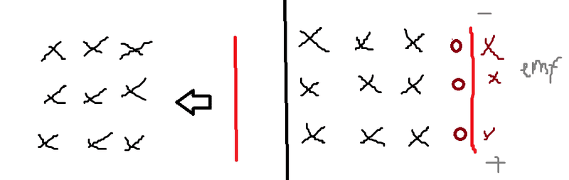

2) Let's say i have a permanent magnet and a wire like in the picture, should there be an emf, in the wires if we move them into or out of the magnetic field of the magnet? Being a wire, it can only produce flux lines (2-D) and they can't oppose the change in magnetic field. The one on the right because it only produces flux perpendicular to the magnetic field of the magnet, the one on the right, because it's a circle, and if one side of the circle counteracts the change of magnetic flux the other helps it.
So basically i think this can be resumed in: can a straight line of wire have an emf on its ends generated by the change of the flux its subject to?
Please do correct any errors in my thinking.

a straight wire moving through a magnetic field will receive an emf
a square wire moving through a uniform magnetic field will receive opposite emfs in opposite sides, so the total emf will be zero
this is because opposite sides are moving in the same direction
if you deform the square so that opposite sides move in opposite directions, the emfs will add :wink:
(and the total emf will of course be proportional to the change in area)

tiny-tim you said a straight wire would have an emf induced
did you mean like this?
(Sorry for my paint skills)
