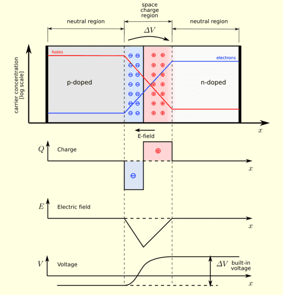

Hi friends, here's my question.
The two terminals of a PN junction are at different potentials so, if I connect a them with a wire i.e. short them, What would happen? Would the potential difference between the two ends becomes zero or what? As far I'm understanding, there would be a flow of electrons from the P region to the N region because of potential difference. But as soon as the PD becomes less, the barrier potential becomes low and therefore the diffusion process will start, in which electrons would move from N to P and so on...
But, this would constitute a current without any battery, etc.
And why can't we measure inbuilt potential difference of the PN junction in Lab using voltmeters.
I'd greatly appreciate any help.
Thank you :)

there's something called a "Depletion Region" where holes in P region get filled by electrons from N region.. and vice versa
http://en.wikipedia.org/wiki/Depletion_region
When enough charge (a minute amount) has moved to complete that process, current ceases.
The potentials are internal and they cancel so external voltage is zero.
You MIGHT be able to measure the charge with an electrometer - i don't know - would make an interesting lab experiment.

the Wilipedia link has a drawing showing the gradient inside the silicon - a picture is worth a thousand words
think of an analogy: two capacitors in series, both charged to maybe 0.1 volt, connected + to +
between their negative leads there is zero volts

I think you are talking about this picture
And I got the concept of the capacitors but, I don't see any analogy. Here, it is clearly shown that the two regions p and n are not at the same potential, the n is at a higher potential and the p at a lower one. So, there is a potential difference between the two terminals.
Please point out if I'm making any mistake in the analysis.
Thank you.
Current will not flow!
Its called the junction potential, and NO, you cannot measure it. First of all it is established across the depletion width at equilibrium. We are not talking of conduction here but rather equilibrium attained during the formation of the depletion width itself. The depletion width is formed (by diffusion across the heterogenenous metallurgical junction) in consistency with Poisson's equation. (Another viewpoint is that it is formed so that Maxwell's equations remain satisfied.)
Remember that the assumption made here is that there is no electric field outside the depletion width! This is an idealization, but it is a reasonably good model at low voltages and for reasonably long devices (with lengths greater than the diffusion length -- the so called long base assumption, a term which comes from BJT terminology).
So, please understand that any act of measuring the junction potential even under the assumption that the contacts are Ohmic and ideal will disturb equilibrium. The diode in this condition is not a voltage source. The potential difference across the depletion width cannot be measured without also accounting for the contact potential at the contacts. A careful calculation will tell you that the contact potential difference exactly equals the junction potential in magnitude with the polarity reversed. So since the 'electrode measurement' will measure the algebraic sum of the contact potential difference and the junction potential, the result will be 0.
The fact that the junction potential cannot be measured directly (and can only be inferred) is very well explained in most standard books on semiconductor physics and devices. Please see for instance the book Operation and Modeling of the MOS Transistor by Yannis Tsividis, or the book Solid State Electronic Devices by Ben Streetman and Sanjoy Banerjee.

The reason there's no external voltage is there's equal and opposing potentials inside and outside the depletion region.
Were this not so, a diode would deflect a voltmeter.

let us do a thought experiment on that picture.
1. Connect a wire from the left side of p region to right side of n region, so that the n and p regions are at same potential.
No current can flow through that wire because the depletion region prevents current flow between n amd p regions.
2. Imagine yourself very small, small enough to walk among the atoms in the silicon crystal.
Imagine also you are carrying a unit positive charge in one hand.
Imagine also you are equipped with a meter that can integrate the product of Force acting on your Unit Charge X Distance traversed. This would be the work done in moving the charge.
Recall what is potential - potential is work done in moving a unit charge from one place to another.
Absolute potential is work to move a charge from infinity to where you are, which is impractical because you can't get out there to make the measurement.
So we always pick some place for a reference and measure potential with respect to that point, hence voltage is a potential "Difference".
So let's call your [edit ] force X distance meter [ /edit] a "Potential Meter". And let's say potential increases when we have to supply the work.
3. Imagine yourself inside the silicon at the left side of p region where wire connects.
You see the crystal structure, orderly atoms with an occasional missing electron.
You set your "potential meter" to zero here.
4. Walk toward right approaching depletion region, and watch your potential meter.
We are approaching a region that has excess electrons, which attract our positive charge, so we are extracting work not supplying it.
Potential meter is decrementing because we are being pulled not pushed.
Note reading when you reach the p edge of depletion region. Negative.
5. Enter depletion region, continue to right. Now we are moving away from negative charge toward positive, so force on our our unit positive charge is other direction, pushing against our travel. Instead of extracting work we are having to supply it. Potential meter is now incrementing.
6. Continue moving right. Note meter reading when you reach n edge of depletion region.
Positive.
7 . Continue moving right through n region. We are moving away from a region of positive charge so force is once again in direction of our travel. Meter resumes incrementing. Note meter reading at right edge of N material.
I submit that your potential meter MUST read zero at three places:
far left where we started,
middle of depletion region,
far right where we ended.
and i submit readings at edges of depletion region are equal and opposite.
My model does not agree with the idealization Maverick pointed out in bold above, 'no field outside depletion region'.
That's doubtless so at distances greater than depletion region's width where distances to positive and negative regions are about the same.
What really goes on at the outside edge of depletion region?
If there's no gradient there, it seems to me it violates Kirchoff.
But i could be wrong.
