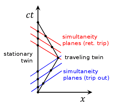

Ah cool, well the first 2 make some sense now. I'll have to read up about simultaneity more to get the first one.
As for the third one, what if the syncing clock was being measured from the inside of the torus, so the distance between the observer and the traveller remains constant? Does the clock simply continuously receive 1 tick for every 2 ticks it sends out? But then from the frame of reference of the traveller, he sees the same, 1 tick for every 2 ticks he sends out. In the "there and back" example, even though the traveller sees Earth as moving slower, Earth fast forwards a few years when he turns around, thereby catching up all that slowed time. But when does the catchup happen in a torus, while the observer is in the middle? During deceleration?
First let's restate the fundamental fact that anchors everything else. Pick one location on the torus and call that point O. The traveller passes through point O once per revolution; call two successive passages of the traveller through point O events A and B. The fundamental fact is that the traveller's elapsed time between events A and B is half the observer's elapsed time between events A and B.
Now: suppose the traveller sends out a light signal each time his clock ticks, and the observer sends out a light signal each time *his* clock ticks. Suppose, for definiteness, that the traveller's clock ticks exactly once per revolution, at the instant he passes point O. Then the traveller will send out a light signal from events A and B. Suppose also, for simplicity, that the traveller *receives* light signals from the observer at events A and B, at the same instants that he sends out his own signals. Call the events at which the observer sends out these two light signals events A' and B'.
Since the traveller's clock ticks once per revolution, the observer's clock will tick twice per revolution. We know the observer's clock ticks at events A' and B' (because he sends out light signals from those events); but it will *also* tick at exactly one event in between them (because it ticks twice per revolution, and there is one revolution between A' and B'). Call that event C', and call the event at which the traveller receives this light signal event C. Then the exact time of event C, by the traveller's clock (i.e., exactly when during his revolution around the torus he receives that light signal), will depend on where the observer is located relative to the torus (because that will affect the light travel time from the observer to various points on the torus).
Some simple examples:
(1) If the observer is located exactly at the center of the torus, then event C will be exactly halfway between events A and B, by the traveller's clock (because the observer is at the same distance from all points on the torus).
(2) If the observer is located exactly at point O, then event C will be *later* than halfway between events A and B (because the observer is co-located with the traveller when he passes point O, so events A and B are co-located with events A' and B'; but event C is *not* co-located with event C', and event C' happens when the traveller is halfway around the torus).
(3) If the observer is located next to the torus at a point exactly opposite point O, then event C will be *earlier* than halfway between events A and B (because event C is co-located with event C', which happens exactly halfway between events A' and B'; but events A and B are *not* co-located with events A' and B', because the traveller is on the opposite side of the torus when A' and B' happen).
You should be able to work out other examples from the above. In all these cases, it's still true that the observer's clock ticks twice per revolution while the traveller's clock ticks once per revolution, i.e., the observer's clock ticks twice as fast as the traveller's. But how that appears in direct observations depends on light travel time as well, which is what is affected by the location of the observer relative to the torus.

What you explained does actually make good sense, but according to STR the traveller must perceive the observer to be slower as well, since motion is relative and the observer is in motion in relation to the traveller just as much as the other way around, except when there is acceleration.
Quote from wikipedia:
When two observers are in relative uniform motion and uninfluenced by any gravitational mass, the point of view of each will be that the other's (moving) clock is ticking at a slower rate than the local clock.
So it would follow, taking your example, both of the observers would receive either A' or B' for every AB pair they send out, right?
The reason I said the observer is in the center is because if he was at point O, then one revolution would be similar to a forward-and-back journey, since when the traveller travels the first half of the revolution, up to the farthest point from O on the torus, that would be like the first leg in a straight line from O's point of view. Then, the farthest point would correspond with the turn-around point as shown here:
and there would be a jump in time at that point (from the traveller's point of view of the observer).
However, if the observer is in the center, the traveller's speed is constant and the traveller's distance to the observer is constant as well, what happens?
