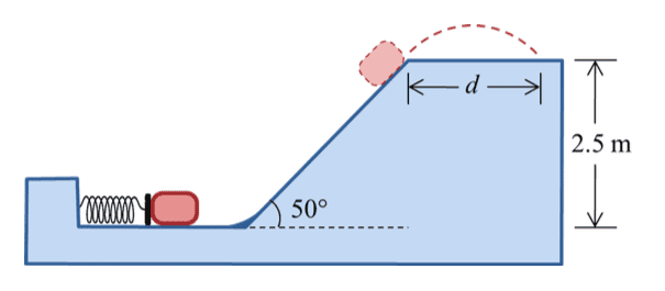

A spring with a spring constant = 1000 N/m is compressed 0.20 m then launches a block of mass 200 g. The horizontal surface is frictionless and the coefficient of kinetic friction with the inline is 0.15.
What horizontal distance does the block cover while in the air after it takes off at the top of the incline?
(diagram attached)
deltaK + deltaUg + deltaUs = 0
(1/2mv^2f -1/2mv^2i) + 0 + (1/2kx^2f - 1/2kx^2i) = 0
1/2mv^2f = 1/2kx^2i
v = sqrt(kx^2/m)
v = 14.14 m/s
Distance up incline:
x = 2.5m/sin50
=3.264 m
Acceleration:
-mgsin0 - ukmgcos0 = ma
a = -gsin50-(0.15)(-9.81)cos50
a = 6.562
Speed at the top:
v^2 = vi^2 +2ad
v = sqrt[14.14^2 + 2(6.562)(3.264)]
v = 15.58 m/s
I'm not sure what the next step would be (also not sure if the above steps are correct).
To find horizontal distance covered would I have to find the horizontal time and then using speed = distance/time solve for distance?
Thanks =]

How can the speed at the top be greater than the speed at the bottom?

Oops I think I got some of the signs wrong
Acceleration:
a = -gsin50-(0.15)(9.81)cos50
a = -8.456 m/s^2
so velocity at the top:
v^2 = vi^2 +2ad
v = 14.14^2 + 2(-8.452)(3.264)
v = 12.03 m/s
OK, much better.
Your idea to find the horizontal distance might not work as you stated it. Can you try something else along the same idea?
paisiello2 said:
OK, much better.
At max height v = 0
Time to reach max height:
t = visin0/g
t = 12.03sin50/9.81
t = 0.9394 seconds
x= xo + vit
x = 0 + (12.03)(0.9394)
x = 11.3 m
Good try but you made two mistakes:
1) The time t you calculated is only the time for the block to reach the maximum height. What about the time it takes to come back down?
2) What direction is vi going in?
Would I have to find the time of flight for the whole range of the parabola first?
time of flight:
y = yo + 1/2gt^2
2.5 = 0 + 1/2(9.81)t^2
t = 0.7143 s
Horizontal distance:
x= xo + vit
x = 0 + (12.03)(0.7143)
x = 8.6 m
No, you break it into separate x and y components. You started off right in your first attempt but didn't finish it for some reason.
