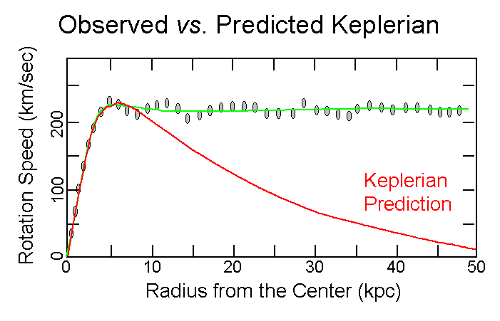

* Looking at the dynamics of stars at the edges of galaxies. These stars act as if they are under a stronger gravitational pull than would be inferred from visible matter alone (which would obey Kepler's law if unmodified general relativity acting on ordinary matter was all that was present). A typical illustration of this from a source at The Ohio State University is shown below:
245644

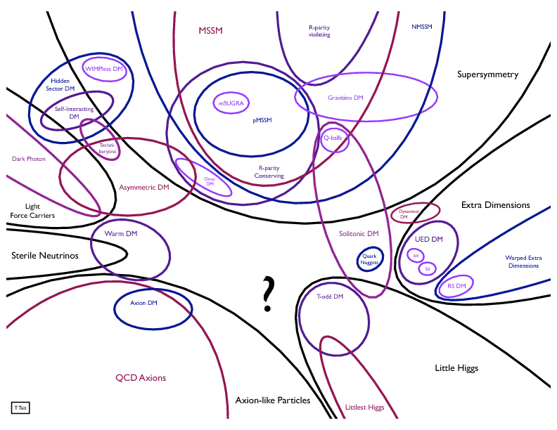

(1) Exotic dark matter particles. There is some sort of nearly collisionless matter, called "dark matter" (although strictly speaking "transparent matter" would be more accurate, since it does not interact with photons) that has existed in a roughly constant amount since the early days of the universe, and have a mean particle velocity that is not relativistic (relativistic dark matter particles are called "hot dark matter" which is a theory that has been ruled out).
Naively, one of the obvious approaches to dark matter phenomena is to infer a distribution of invisible matter that isn't interacting in any non-gravitational way that we can observe from the gravitational dynamics of what we do observe. Those inferences suggest that dark matter particles should be diffuse, should be located in roughly spherical halos around galaxies and immersing galactic clusters with greater concentrations around galaxies, should be long lived or have annihilation and creation quantities in near equilibrium, should not have a huge annihilation signal that can be detected (although it might have a subtle one), and should not be very clumpy. Different theories propose masses for dark matter particles from masses smaller than neutrinos to masses as large as asteroids. Most dark matter particles theories proposed dark matter predominantly made of one type of particle (because multiple types of dark matter performed worse in early simulation efforts at reproducing what is observed), but that isn't a definitively proved matter either.
Pretty much all of these theories proposed kinds of matter not found in the Standard Model of Particle Physics except primordial black hole dark matter which proposed that black holes smaller than the roughly three stellar mass minimum for their formation in modern times arose by some unknown mechanism in the early universe, which has an ever shrinking but not yet entirely ruled out parameter space. This is because unobservable non-luminous ordinary matter (a class of theories dominated by what are called MACHOs for massive compact halo objects like very dim stars and gas giants) have been largely ruled out because their behavior would be inconsistent with astronomy observations to date.
A chart presenting some of these possibilities (via Stacy McGaugh) is as follows:
245645
A few more possibilities are discussed in more easily accessible language in this 2015 article.

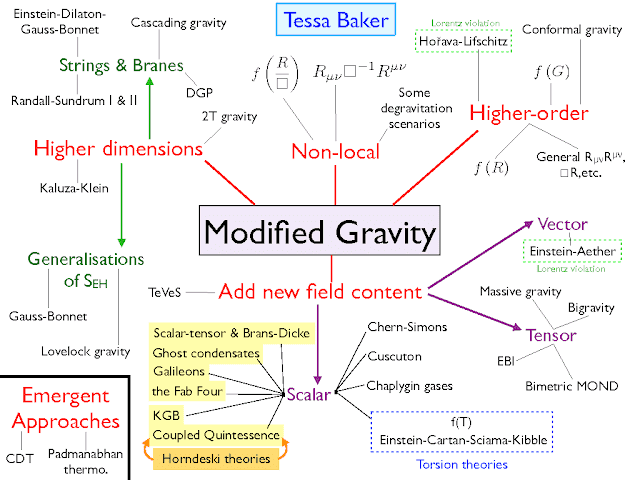

(2) Modified Gravity. General relativity does not accurately model the weak field behavior of gravity and/or inertia and needs to be modified in some respect to describe reality. Inertia based approaches sometimes see inertia as arising from Mach's Principle (i.e. from the collective gravitational pull of everything else in the universe). Fifth force explanations that don't strictly speaking modify gravity itself (arguably including Verlinde's entropic gravity) are also usually lumped into the modified gravity category.
A chart presenting some of these possibilities (from a conference presentation made by Dr. Tessa Baker, also via Stacy McGaugh) is as follows:
245646
