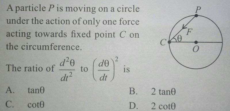

What is the acceleration normal to PC in polar coordinates?

Since the force is always directed towards C , angular momentum about C should be conserved . But that doesn't seem to help as we need the relation at any general angle .
How should I proceed ?

Point P moves along a circle centered at point O. Knowing that the force exerted on it points towards C, what are the radial and tangential accelerations in terms of theta?

If it were moving only under the force acting towards C, it wouldn't be moving in a circle as shown. It has both radial and tangential accelerations.

I did. It's the 'net force' that acts towards C. It has both radial and tangential components such that the particle moves on a circle as shown.

Fortunately, we don't have to analyse the nature of force in the question. You can arrive at the answer with elementary trig and vector algebra.

Yes, and the condition under which it is possible is what the question is asking for.

I get option a) . Do you get the same ?

Sorry . I am actually getting option b) .

Unless I made some stupid mistake, it's d).

You calculated (d2θ/dt2)/ (dθ/dt)2 right? It comes out to be 2cotθ.
I think you calculated the reciprocal.

I also get (B). Consider θ=0. Would it not make sense that ##\ddot\theta=0## but ##\dot\theta<0##?

You're right!
In my working, I had drawn the 2 radii perpendicular to each other in the diagram, so my θ was 45 degrees there. And using the alternate angles, I concluded that tanθ=Ft/Fr. Actually, tanθ=cotθ at θ=45°, so my assumption worked for θ=45° but it's actually cotθ=Ft/Fr.
Tricked by my own drawing!

I don't think so. The force points to C, but its magnitude changes along the circle. It is zero at C and highest at the opposite point.

Yes. The necessary and sufficient condition that the motion is controlled by such a force is one of the equations needed to arrive at the desired equation.

No. The trajectory would need to be an ellipse with the source of the force at one focus. Yes, a circle is a special case of an ellipse but its focus would be at the centre, not on the circumference.

You do not know the magnitude of the force towards the origin, but you do know the magnitude in another direction.
