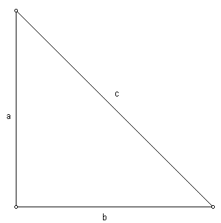

evenmu
NH3 (ammonia) that is shown in the picture. These three hydrogen-atoms is formed as triangle.
Center of the triangle has a distance d = 0.940 from each hydrogen atom.
The nitrogen atom located in the vertex of a pyramid in which the three hydrogens defines "the base". Vertex is vertically above the center of the triangle. The ratio of the atomic masses of nitrogen and hydrogen is MN/MH = 13.9 and nitrogen-hydrogen length is L = 1.014.
Data:
d = 0.940
MN/MH = 13.9
L = 1.014
picture of the situation: https://www.dropbox.com/s/ruakers7j0zgg1w/Photo%2023.10.12%2020%2054%2019.jpg
Determine the x-and y-coordinate of the molecule center of mass ?

the centre of mass is obviously on that "vertical" line marked y
what proportion of the way along the line is it?
and how long is that line? :wink:
So, you mean that I can treat this as a right-angled triangle and find the center of mass from that ?
no, i mean that you can treat this as a straight line,
and find the center of mass as if the three hydrogen atoms were all together at one end :wink:

Here is what I have done until now:
L = 1.014m
d= 0.940m
(pytagoras)
a =√(L2)-(d2) = 0.38m
Then i set up the Ceter of mass for X- and Y-axis. Like this:
XCM = 1/M (3*(MN/13.9)*(0.940m) + (13.9MH)*(0m)
And the same for Y-axis.
Is this right, or am I doing something wrong here?
L = 1.014m
d= 0.940m
(pytagoras)
fine so far :smile:

you needn't bother with the x and z coordinates …
from symmetry, aren't they obviously 0 ?
as to the y coordinate …
yCM = 1/(MN + 3MH) [(MN)*(a) + (3MH)*(0m)]

I calculate YCM and got YCM = 0.31. Do you think that this answer is realistic, in relation to the drawing ?
let's see …
a = .38, so it's roughly 14/(14+3) times .38, = .31 …
yup, looks ok :smile:
(but that's not metres, is it? :biggrin:)
