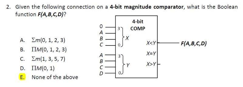

What is the correct answer for the 4 bit magnitude comparator homework?

As long as A = 1, its true, So options (A) and (C) are wrong. My ans is (E). Right?[/B]
As far as I can guess from the figure, the input at Y is at least twice that of the input at X (left shift). Thus F is TRUE.
Except when all zeroes right?
Right.
