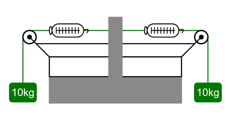

The discussion revolves around a mass/scale puzzle involving a scale, weights, and pulleys. Participants explore the reading on the scale under various scenarios, focusing on the concepts of tension in the rope and the forces acting on the system. The conversation includes theoretical reasoning and attempts to clarify the mechanics involved.
  • Some participants assert that the scale reads 10kg based on the assumption that the tension in the cable remains constant throughout the system.
  • Others argue that the rope can only have one tension, challenging the idea that it could be 10kg for each weight and 20kg in the middle.
  • A participant proposes a scenario where the left pulley is fixed and the left weight is cut, suggesting that the scale should still read 10kg.
  • Another participant clarifies that fixing the left pulley does not constrain the left cable, which could lead to different outcomes.
  • Some participants emphasize that the tension in the cable must balance the gravitational force on the weight, leading to the conclusion that the scale measures the tension directly.

DaveC426913 said:
I get that, if you hung a 10kg mass from the ceiling, there is 10kg pulling down and 10 kg pulling up.
I think that's the crux. All the pulleys do is change one of them from 'up' to 'down'. No, that would cancel to zero. :sorry:
Is there a FBD diagram that would demonstrate the solution?
Maybe show why I think there's a missing 10kg? Will it show 5kg pulling on each end of the scale?
How would you solve this problem - with formulae, say, on an test?

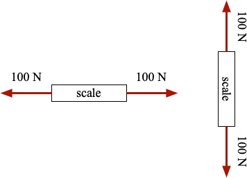

Is it? Consider the two configurations 1 and 2 below:
Anthropomorphizing the scale, it can only "see" (respond to) what's inside the red ellipses. From the scale's local perspective (neglecting the gravitational sag of the horizontal cable in 1) there is no difference in the two configurations and so it responds identically to both. How could it be otherwise? It doesn't even require a calculation!

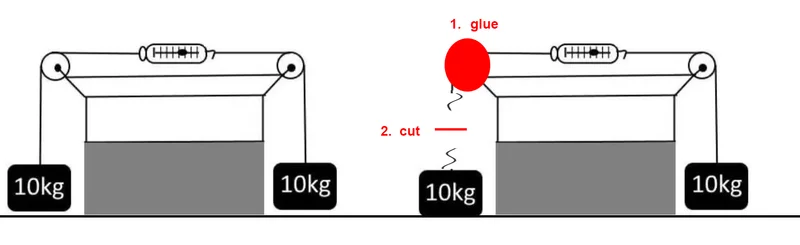

I don't know how many times I can say that "I figured this out in the opening post".
1. Glue the left pulley and its cable together so it can't move.
2. Cut left weight loose.
3. Nothing happens. The scale stays where it is. And it it now obvious at a glance that the answer must be 10kg now, which means it must have been 10kg before.
I get that.
What I don't get is how one can solve this without a long explanation that requires changing the scenario to prove the point. Surely basic physics problems aren't solved by saying "Here is a long explanation".
Surely the diagram, as-given, can be labelled.
But it seems not. I give up. It's not worth aggravating everyone and tarnishing my immaculate reputation. :sorry:

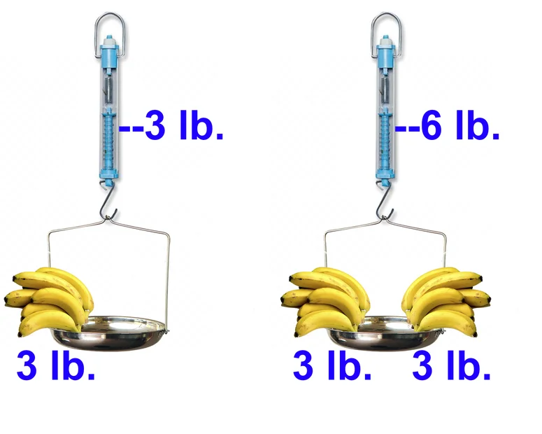

No, it would read 6lb if I had 3lb of bananas hanging off one side and 3lb off the other side.
Nope. I've done this demonstration for students many many times.
What difference does it make what pulls with 3 lb of force? It could be a ceiling, it could be a brick fastened to the table top, it could be another 3 lb of bananas.
If the scale hangs from the ceiling by a cable, and the scale reads 3 lb because 3 lb of bananas hang from the scale, what is the tension in that cable that hangs from the ceiling?
No. It really would require 6lb of bananas for the a scale to read 6lb. I think we are talking past each other.
Those 3 lb of bananas hanging off the other side of the scale are pulling down on the scale, not up. The scale will read 6 lbs in the scenario you describe in post 28.
Er. 3 lb?
This is what you said:
I don't see that as talking past each other. It's you contradicting yourself. The scale either reads 3 lb or it doesn't. And I'm telling you that if you hang 3 lb of bananas on each side, the scale reads 3 lb, even though you have a total of 6 lb of bananas.
So you're saying that hanging 3 lb of bananas from a scale (which is what I describe in Post #28) makes the scale read 6 lb?! I suggest a trip to the produce department of your local grocery store.
DaveC426913 said:
Er. 3 lb?
The tension in the cable pulling down on the scale is 3 lb, and the tension in the cable pulling up on the scale is 3 lb, and the scale reads 3 lb.
DaveC426913 said:
But this is a different scenario.
In the different scenario the tension in the cable pulling to the right on the scale is 100 N, the tension in the cable pulling to the left on the scale is 100 N, and the scale reads 10 kg.

DaveC426913 said:
What's being asked is "why isn't that same force everywhere equal to 20?"
Think about one mass. It has a downwards force of 100N due to gravity, so the upward force from the string must also be 100N or it would move.
Now think of the string attached to that mass. It has a 100N force on one end, so it must have a 100N force on the other end or it would move.
So the spring must be exerting a 100N force.
Repeat the process from the other end.
So the spring is exerting a 100N force at each end. Its scale is calibrated so that it reads 10kg under those circumstances (because otherwise it wouldn't do its job in normal vertical operation). The end.

DaveC426913 said:
I just don't follow why it's still only 10kg except by using the "look at this alternate scenario" method.
You can try a free body diagram that includes as separate components the hook on the scale and the case of the scale. The hook is subject to the force from the string and from the spring; it is not accelerating so these forces must cancel. The case is subject to the force from the spring and from the string on the other side; again these must cancel as there is no acceleration. Then you can add the third law partners of all four of these forces to satisfy yourself that the force pulling the hook end of the spring away from the case (which is what the scale actually reads) is equal to the tension in the string is equal to the force required to hold either of the weights stationary against gravity.

  • #57
I was trying to give you the benefit of the doubt.
You appear to be doubling-down on the assertion that a scale suspended from the ceiling that is holding 3lb of bananas and another 3lb of bananas will show only 3lb, not 6lb.
Mister T: " Do you honestly believe that when you hang 3 lb of bananas from a spring scale the scale will read 6 lb?
DaveC: "No, it would read 6lb if I had 3lb of bananas hanging off one side and 3lb off the other side."
Oh. I see whats happening.
A spring scale for weighing bananas is vertical; it is not like the initial scenario. It doesn't have pulleys, and its spring is not between two weighed items.
Diagram 1 is what I pictured when you raised the idea of hanging bananas from a spring scale.
Diagram 2 is what I meant in my response when I said "you'd have to hang another 3 lb. off the other side to get 6 lb.".
I think we can agree both diagrams are correct. But probably not what you were picturing.
No.
We were talking past each other. We had two different ideas of the banana scenario in our head.
I thought you were changing more of the scenario than you may have meant - as I explain above. (In my defense, if you follow the thread, you will see why. Several contributors have proposed scenarios with scales hanging from the ceiling, so it's not a big leap to make.)
Right, and the only way it would read 6 lb. is if there is a second 3 lb. bunch of bananas in the mix.

berkeman said:
I think you meant something more like "attach the left cable to a wall instead of the pulley and weight... :smile:
DaveC426913 said:
I have to assume there's more direct explanation, one that simply analyzes the given diagram irecxtly.
I have to ask pointedly what could be more elegant and direct than " take a big old wad of glue and splooge one of the pulleys to the mount" ?
Enough said IMHO
  • #60
Here are two free-body diagrams of the scale. One for your scenario (left) and one for the scale suspended from the ceiling (right). As you said, the scale hanging from the ceiling will read 10 kg or 100 N.
